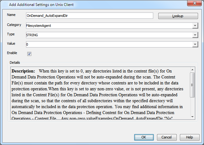

config_ondemand_reg_key

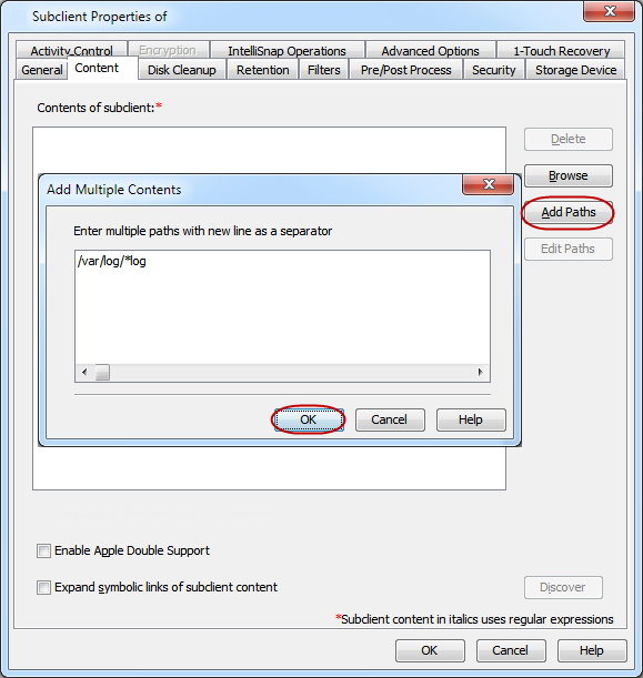

  6. Click the Content tab.
  7. Click Add Paths.
  9. Click OK.
add_content_widlcards_snp

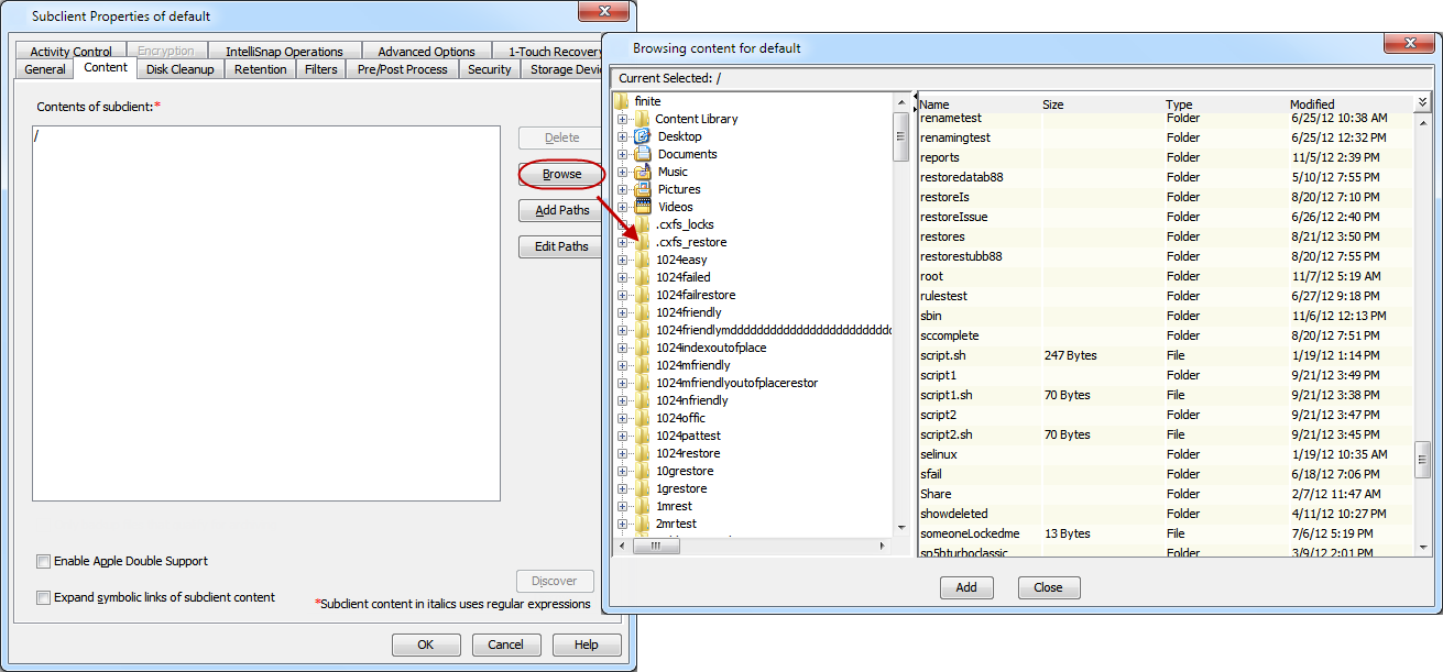

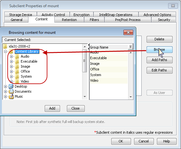

  7. Click Browse.
  10. Click OK.

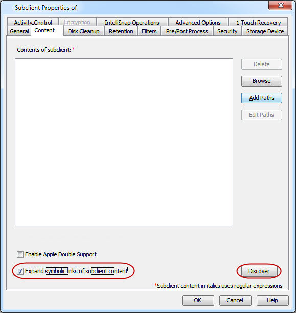

expand_sym_links_snp
  3. Click the Content tab.
  4. Click Browse.
  6. Click Close.
  8. Click OK.
expand_sym_links_sc

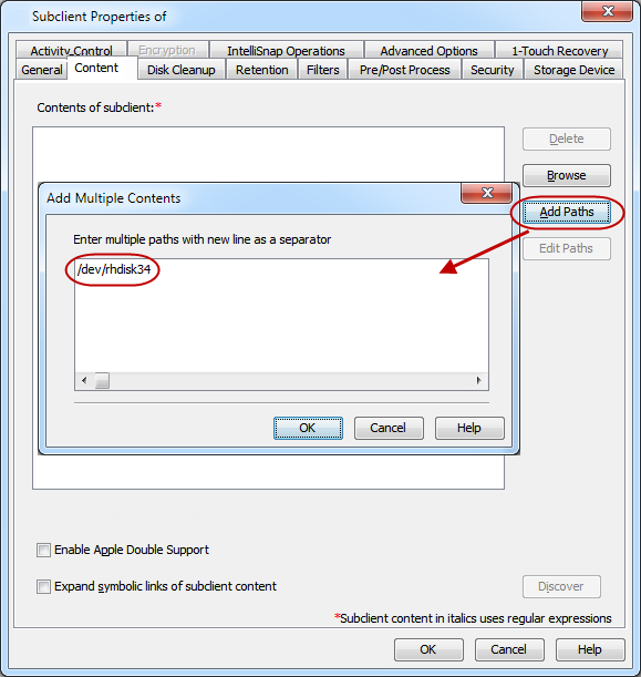

  • Raw devices are backed up using Full Backups.
  • Click the Content tab.
  • Click Add Paths.
  • Click OK.
raw_device_snp

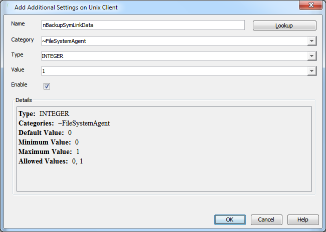

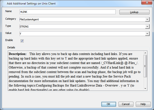

By default, hard links are ignored during backups and the data is duplicated thus taking up additional storage space. You can prevent such data duplication when backing up hard-linked files and also preserve hard links during restores using the following steps.
Additional disk space is required for the job results directory, for more information see Job Results Directory Disk Space Calculation.
  4. Click Add.
  5. In the Name field, type HLINKSNAP.
  6. In the Value field, type Y.
  7. Click OK.

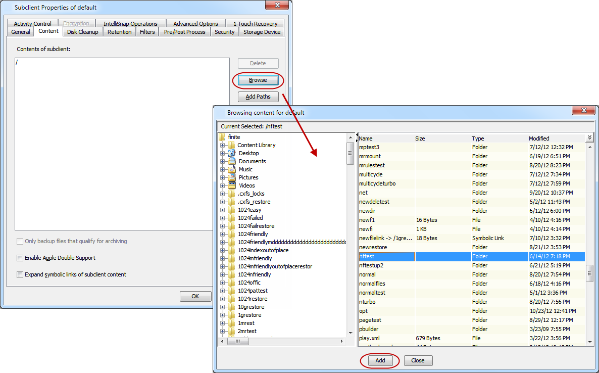

By default, the NFS-mounted file systems are not included in the default subclient. You can include the NFS-mounted file systems using either of the following methods:
  4. Click Browse.
  6. Click Add.
  7. Click Close.
  8. Click OK.
bkp_nfs_mnt

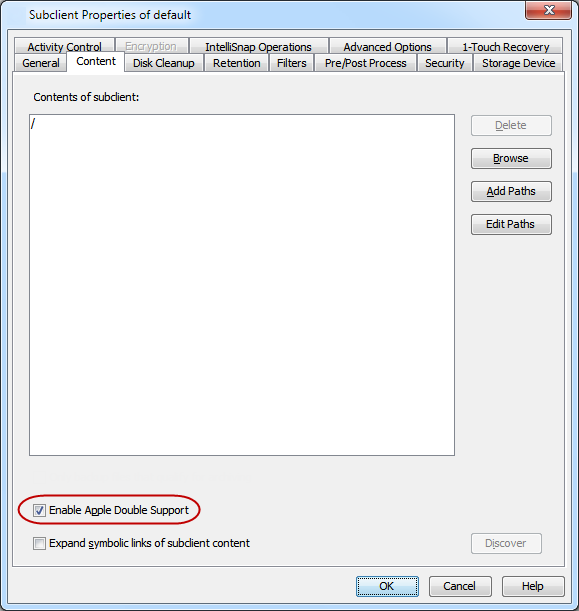

Configuring Backups for Macintosh Files
By default, the File System iDataAgent backs up Macintosh files on a shared mount point. During these backups, if the data on the Macintosh file system share are Apple Double formatted files, they are backed up as two separate files.
Use the following steps to backup the Apple Double formatted Macintosh files as a single file:
  5. Click OK.

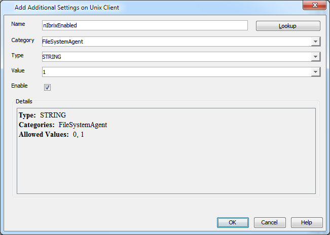

Configuring Restores for X9000 IBRIX Files
Use the following steps to enable restore of X9000 IBRIX files appropriately. When enabled, the files will be created initially with 600 permissions and the original permissions are applied to the files when they are closed.
  2. Right-click <Client> and then click Properties.
  4. Click Add.
  5. In the Name field, type nIbrixEnabled.
  7. Click OK.

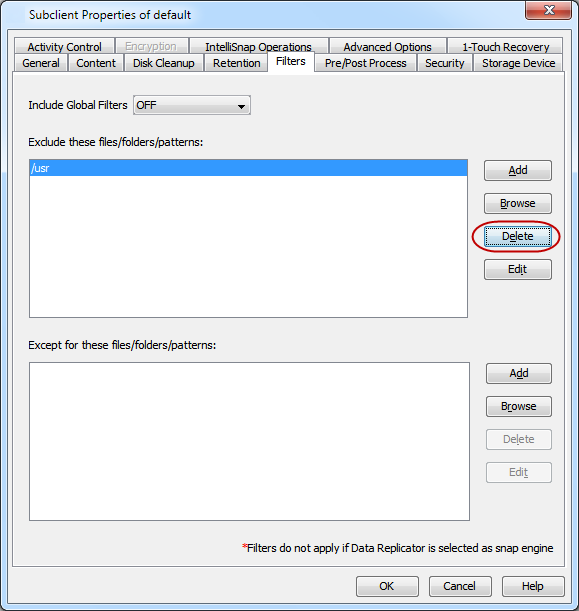

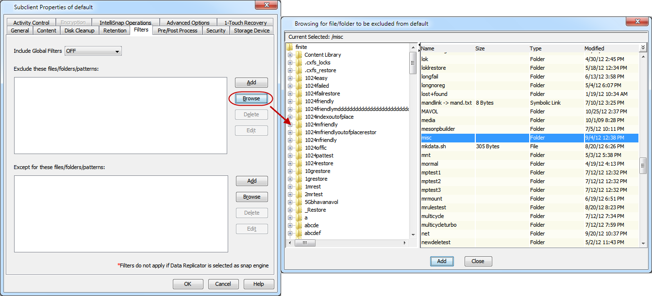

Filtering Files from a Backup
  3. Click the Filters tab.
  7. Click Close.
  8. Click OK.
filters

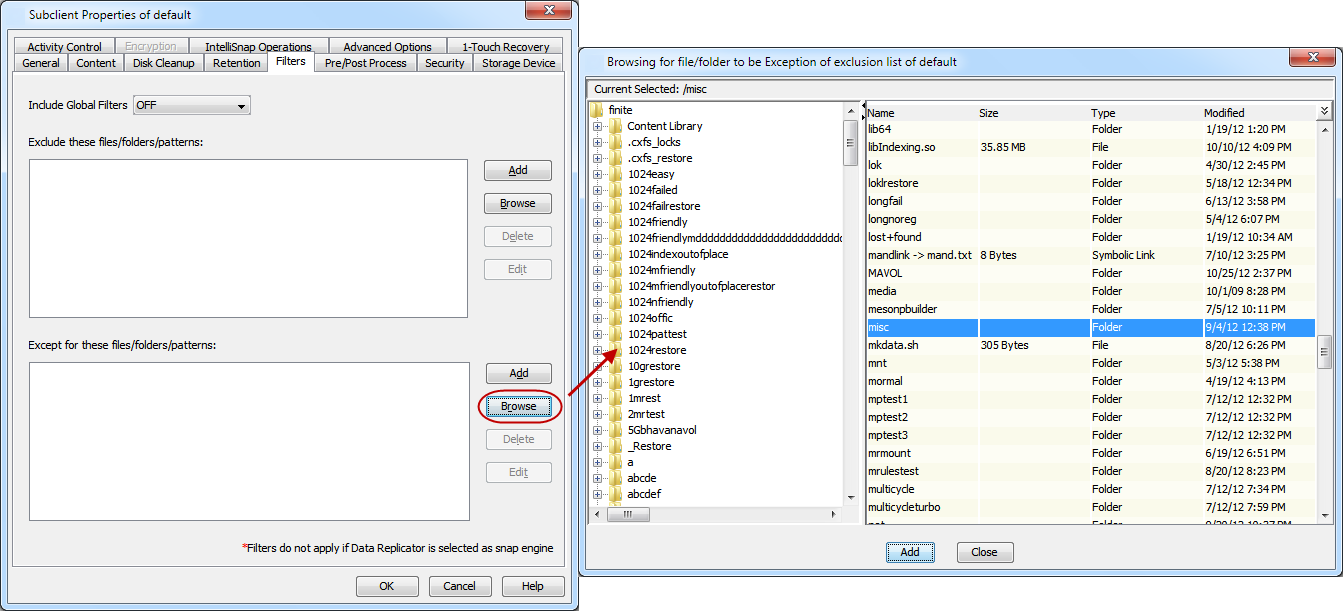

Notes:
  6. Click Close.
  7. Click OK.
filters_exception
Deleting a Filter
  5. Click Delete.
filters_delete

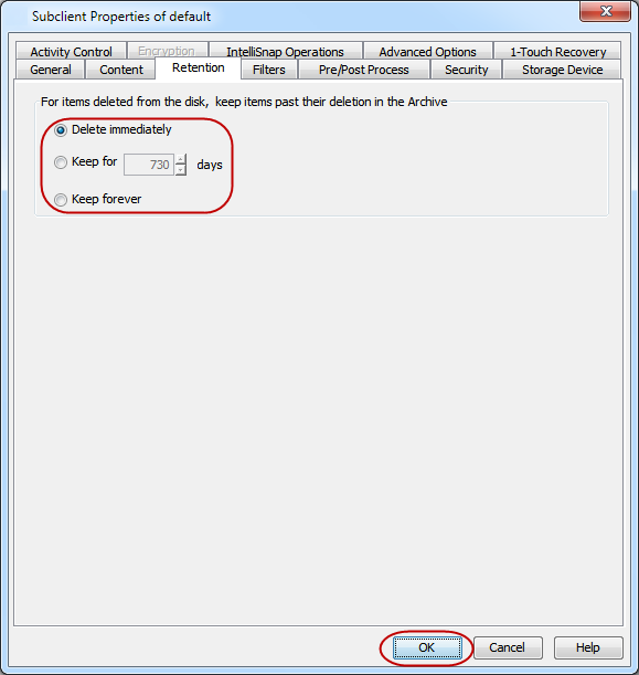

Use these options to retain items deleted from the disk within the archive. You can configure to keep deleted items for specified number of days after deletion or forever. You my also choose to delete these items forever.
  1. From the CommCell Browser, navigate to Client Computers | <Client> | <Agent> | <BackupSet>.
  2. Right-click the Subclient on the right pane, and then click Properties.
  3. Click the Retention tab.
  4. Select from one of the following options:
    • Delete Immediately
      By default, the deleted items are deleted immediately from the archive.
    • Keep for n days
      Select and enter the number of days for which you want to keep the deleted items available in the archive after deletion.
    • Keep forever
      Select to retain deleted items forever.
      Data moved from one subclient to another is also considered as deleted item and would be included for deleted items backup.
  5. Click OK.

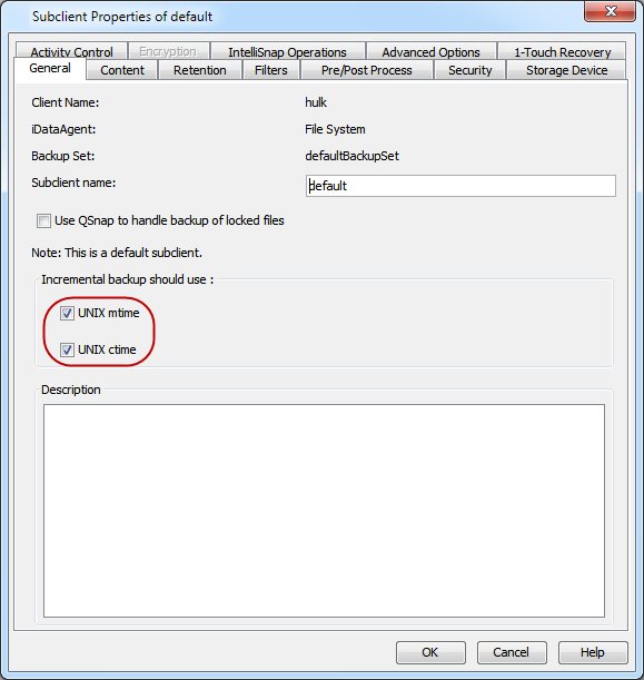

  4. Click Add.
    • Y - to include mtime
    • N - to include ctime
  7. Click OK.
file_archiver_mtime_ctime

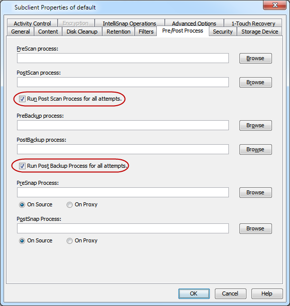

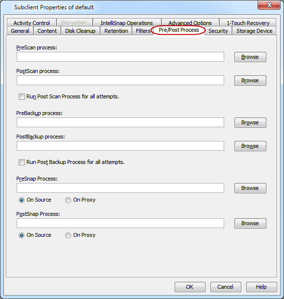

pre_post
pre_post_failure
Use these arguments:

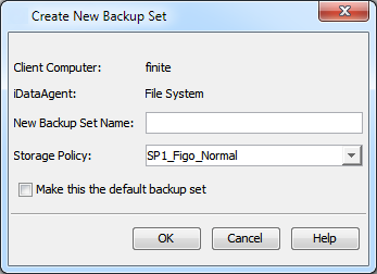

Renaming BackupSet:
  1. From the CommCell Browser, navigate to Client Computers |<Client>| File System.
  4. Click OK.
