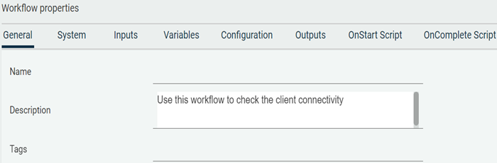

Configure the Workflow
On the General tab, complete the following:
In the Name box, enter a name for the workflow.
In the Description box, enter a brief description about the workflow.

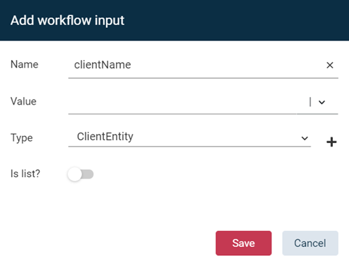

On the Inputs tab, define a variable for the client name:
Click Add.
The Add workflow input dialog box appears.
In the Name box, enter clientName.
Beside the Type list, click +.
The Select Type dialog box appears.
Expand CvEntities, and then select ClientEntity.
Click Save.

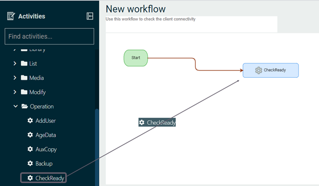

From the Activities pane, go to QCommands > Operations.
Select and drag the CheckReady activity into the design area.
This activity runs the qoperation checkready command.

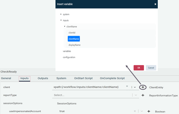

On the Inputs tab, complete the following:
Beside client, click +.
The Insert variable dialog box appears.
Go to system > workflowEngine, and then select clientName.
From the reportType list, select the level of detail that you want to see in the report.

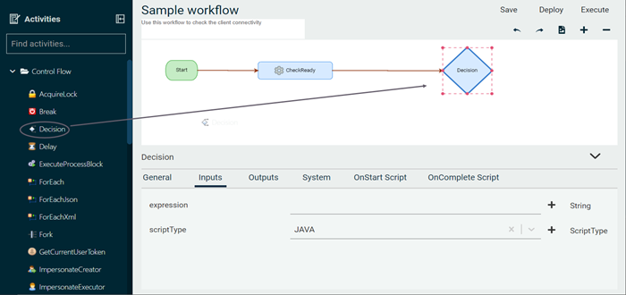

Configure the Decision Activity
From the Activities pane, go to Control Flow > Decision.
Select the Decision activity, and then drag it into the design area.
The Decision activity verifies that the Client Readiness Report activity completed successfully.

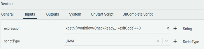

In the design area, select the Decision activity.
The properties for the Decision activity appears at the bottom of the design area.
On the General tab, in the Display Name box, rename the activity to Report Ready?.

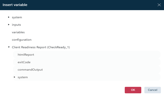

Beside Expression, click +.
Go to Client Readiness Report, and then select exitCode.
Add ==0 to the expression value.
The value should look as:
xpath:{/worfkflow/CheckReady_1/exitCode} ==0. This expression verifies that the exit code of Client Readiness Report is 0.

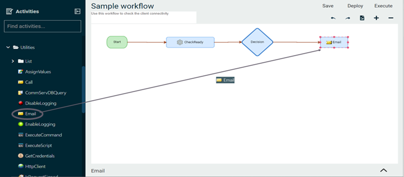

Set Up an Email Activity to Send a Notification When the CheckReady Command Succeeds
Go to Activities > Utilities.
Select the Email activity, and then drag it into the design area.
In the design area, select the Email activity.
The properties for the Email activity appears at the bottom of the design area.
On the General tab, in the Display Name, rename the activity to Success Email.
If the qoperation CheckReady command succeeds, the Success Email activity sends an email notification to the specified email address.

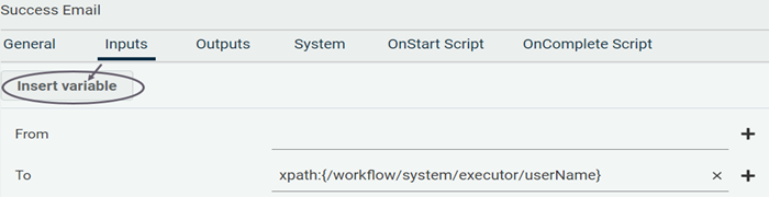

On the Inputs tab, do the following:
Step |
Procedure |
Specify the email recipient |
Specify the email subject |
Configure the email body |
Step
Beside the To box, click the Insert variable + button,
Go to system > executor, and then select userName.
In the To box, enter a semicolon (;) next to the variable, and enter xpath:{/workflow/system/executor/userName}

Go to system, and then select jobID.
Similarly, insert the commandOutput variable.

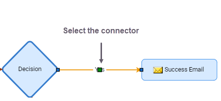

Configure the true and false transitions for the Is Report Ready activity:

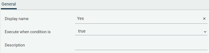

Specify the true conditional transition:
- Select the connector (arrow) between Is Report Ready activity and Success Mail activity.
In the Display Name box, enter Yes.
From the Execute when condition is list, select true.

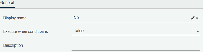

Specify the false condition:
Select the connector (arrow) between Is Report Ready activity and Failure Mail activity.
In the Display Name, enter No.
From the Execute when condition is list, select false.
