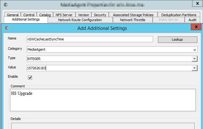

  9. Create the following entries:
    # echo "sHyperScaleRemoteCache Yes" >> /etc/CommVaultRegistry/Galaxy/Instance001/MediaAgent/.properties
    vi $[/etc/CommVaultRegistry/Galaxy/Instance001/MediaAgent]/.properties nSWCacheLastSyncTime $[Current_UNIX_time]
    Where:
    <Current_UNIX_time> is the UNIX time obtained in step 8.
  10. Verify the value:
    [root@hyperscale-hs1 $[MediaAgent]]# pwd $[/etc/CommVaultRegistry/Galaxy/Instance001/MediaAgent] [root@hyperscale-hs1 $[MediaAgent]]# cat .properties nSWCacheLastSyncTime $[Current_UNIX_time]
    Alternatively, manually add the following Additional Setting on the Control Node using the CommCell Console:
    The values in setting will not be automatically populated.
