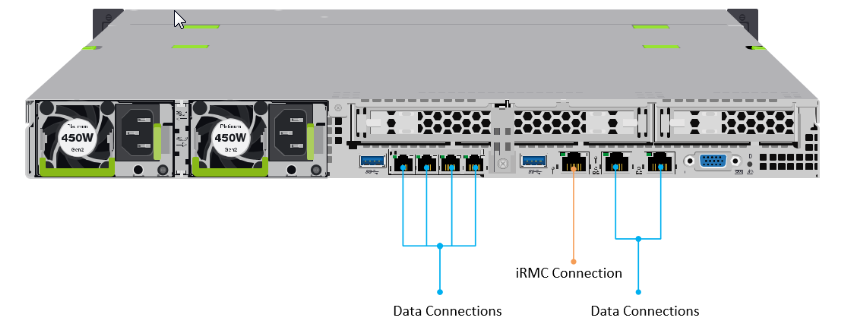

Cabling the Network
There are six 1 GbE network ports on the rear of the appliance for data access.These ports can be used to meet various network demands, such as when ingesting data, data recovery, and DASH copy.
IMPORTANT: The default 10 GB ports on a Commvault appliance only supports the optical or twinax copper SFP+ connections. Commvault appliances do NOT support RJ45 based connections without a separate adapter purchase. Before ordering, confirm the type of network connections needed for the setup.
  • The 1Gb Ethernet wrench port is connected to the iRMC (integrated Remote Management Console).
  • All data management tasks including backups and restores as well as Virtual Commserve connectivity are established through the 1GbE data ports. Bonding is also available on the appliance.
  • An optional dual port 10 GbE is also available.
  • Connect the 1 GbE data network to your public or production (Data) network.
  • Connect the 1GbE iRMC, or integrated Remote Management Console, to your management network. This can be connected to the same network as the data network if desired.
