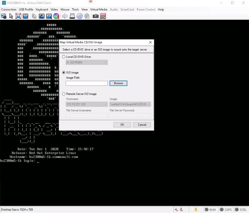

  3. Access the node using the KVM management console in your environment and map the downloaded ISO image as a virtual media from the KVM Management console.
    Click here to view a sample image.
    Sample KVM Console (1)

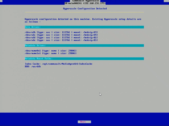

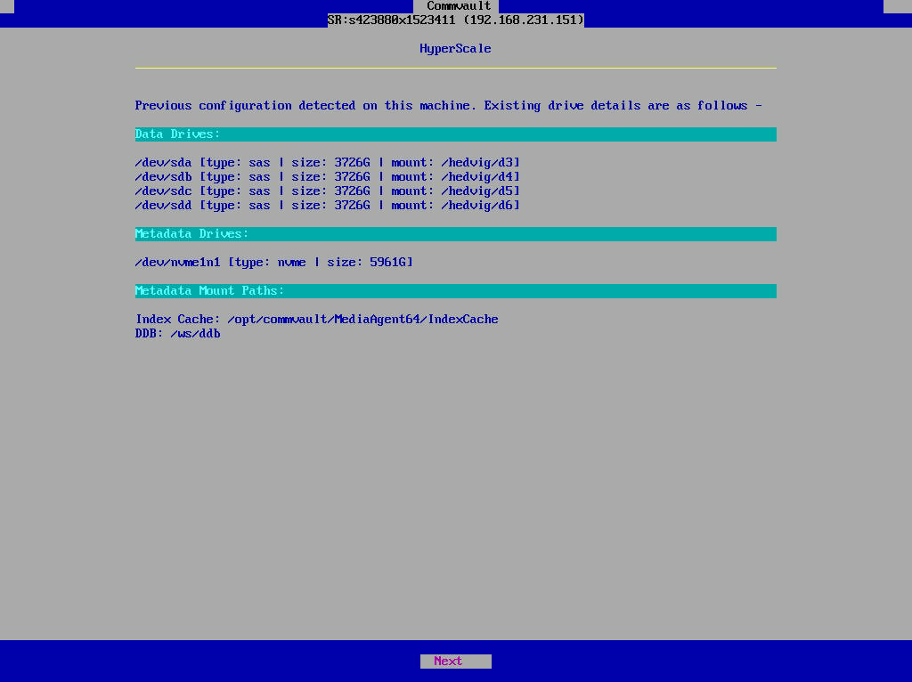

  5. The HyperScale Configuration Detected screen is displayed.
    The screen may look different, depending on the number of drives.
    Recovering an HyperScale X Appliance Node (1)
    Choose Next.
    The installation process will start. This process will take some time to complete.

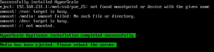

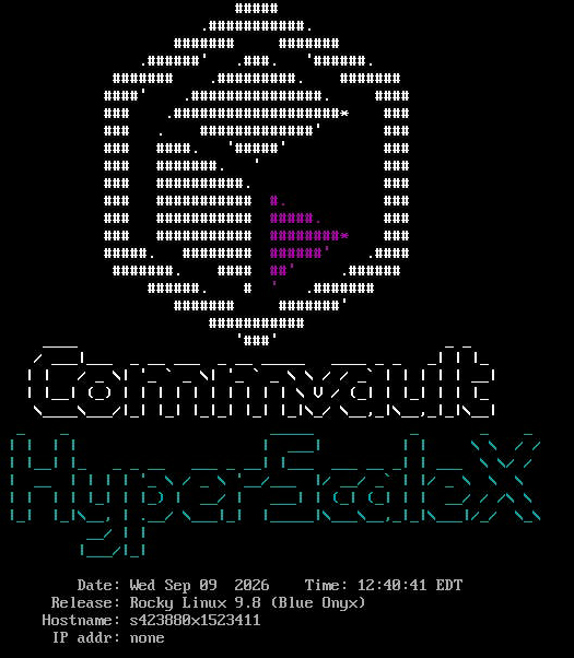

  6. After the installation is completes, the node reboots automatically.
    If you see the following warning you must go to the raid controller in the node and create a RAID 1 logical volume with /dev/sda and /dev/sdb drives for the OS install.
    embd_GettingInstallationMedia (1)

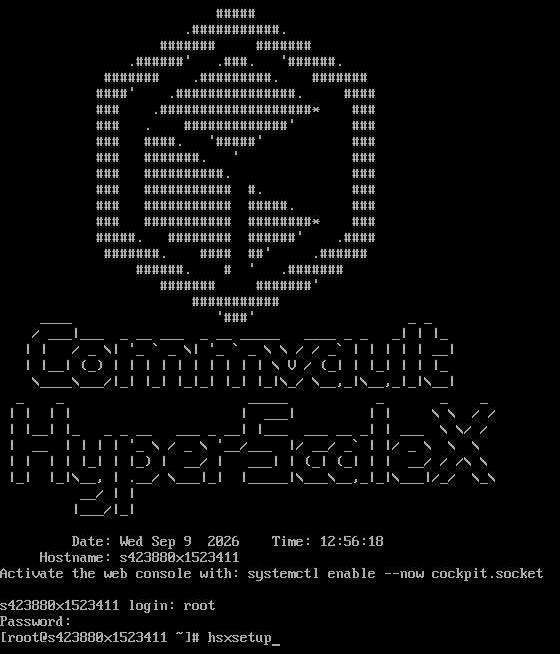

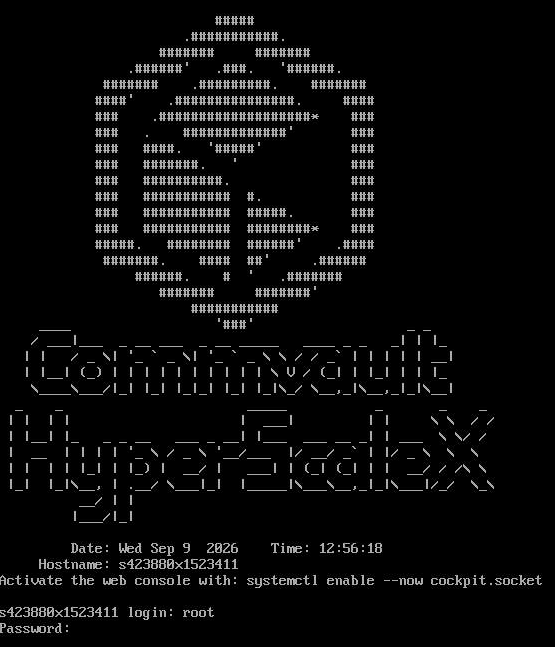

  7. After reboot, launch the installer using the following default credentials:
    Login: root
    Password: cvadmin
    (Press <Alt> + <Ctrl> + <F2> if the login prompt is not displayed.)
    This password can be changed during setup.
    Important: Note down the Hostname, which is the node serial number. This will be useful to identify the node when you deploy the HyperScale X Reference Architecture software.
