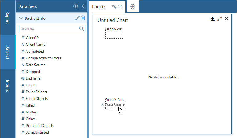

  5. From the Data Sets list, drag an alphabetic-type field name to the Drop X-Axis box.
    bar_drop_x_axis
    By default, the Y-Axis will display a count of the field that you selected for the X-Axis.

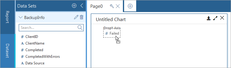

  6. If you want to graph something other than the default, delete the Y-Axis selection, and from the Data Sets list, drag another field name to the Drop Y-Axis box.
    bar_drop_y_axis
    A list appears under Drop Y-Axis.
