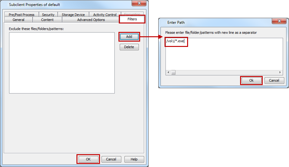

  1. From the CommCell Browser, go to Client Computers > client > NDMP > backup _set.
  2. In the right pane, right-click the subclient, and then click Properties.
  3. On the Filters tab, under Exclude these files/folders/patterns, click Add.
  4. In the Enter Path box, type the paths or names of files and directories that you want to exclude.
    If you want to specify a file name pattern, you can use wildcards in the filter strings. The filter strings are case-sensitive.
    For example: If you want to filter all the filenames starting with LICENSE, specify LICENSE*. However, filenames starting with license (in lowercase) will not be filtered.
  5. Click OK.
