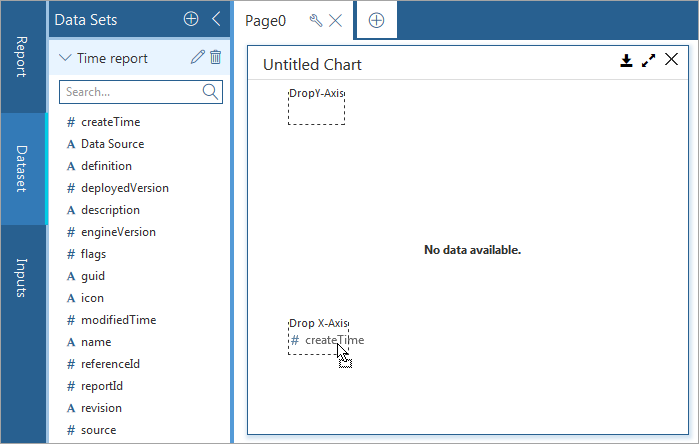

  5. From the Data Sets list, drag a field name to the Drop X-Axis box.
    Timeline charts support only time stamp, date, and integer field types for the first field in the Drop X-Axis box. While integer field types are allowed, they are assumed to be UNIX timestamps in Coordinated Universal Time (UTC).
    You can add alphabetic-type fields to the Drop X-Axis box as a secondary piece of information.
    line_drop_x_axis
