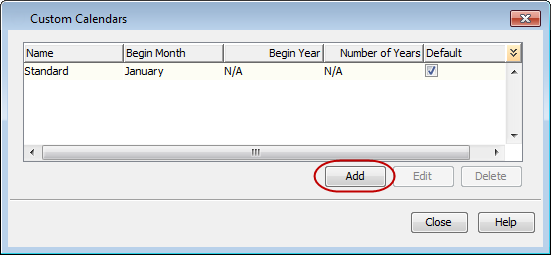

  1. From the CommCell Console toolbar, click Control Panel.
    Under the Schedule section, click Custom Calendars.
  2. Click Add.
    add_calendar

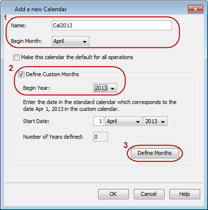

  3. Specify the following details for the new calendar:
    • In the Name box, type the calendar name.
    • Select April as starting month of the year from the Begin Month drop-down list.
    • Click the Define Custom Months check box.
    • Select the year in which calendar has to begin from the Begin Year drop-down list.
    • Click Define Months to configure the months.
    create_calendar_sample_01

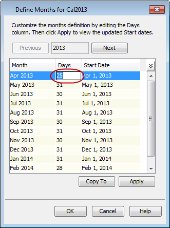

  4. For the month of April, double-click the days in the Days column to specify the new number of days.
    • By default it shows the actual number of days for the month as per the Georgian calendar.
    • The Start Date of each month adjusts accordingly based on the number of days specified for the month of April.
  5. Click Apply and then click OK.
