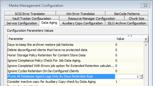

    As this is an unlinked log backup, by default, this will follow the unique data aging rules for log backups. If you want such log backups to be aged according to the defined days retention rule for the data, you can do so as follows:
    1. From the CommCell Console, click the Storage tab.
    2. Click the Media Management icon.
    3. Click the Data Aging tab.
    4. In the Prune All Database Agent Logs Only By Days Retention Rule, type 1 to enable pruning for all database agent logs based on the days retention.
    5. Click OK.
