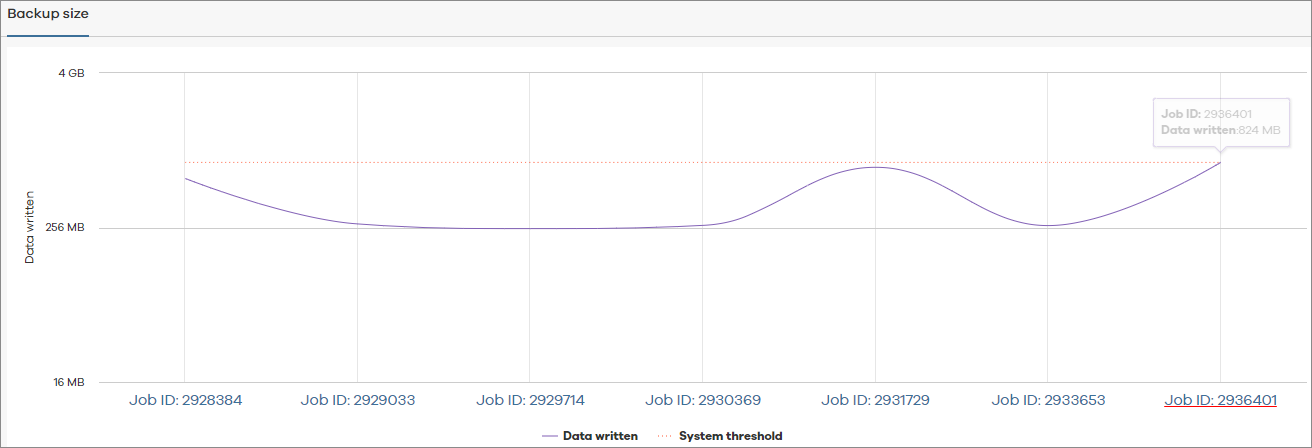

Backup Size Chart
The Backup Size chart displays the amount of data written for the last 7 backup jobs, along with a system-defined threshold (dashed line).
The following image is an example of the Backup Size chart for VM backup size anomalies:
Threat Indicators report for size-related anomalies - VM
