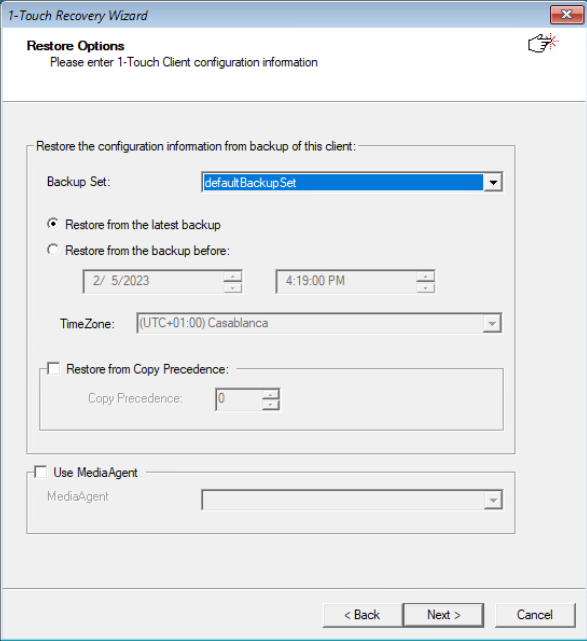

  8. On the Restore Options page, review the restore options, and then click Next.
    interactive_restore_new_6

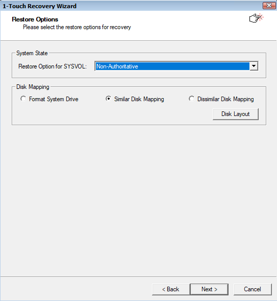

  9. On the next page of Restore Options, review the restore options as follows:
    1. In the System State section, select Non-Authoritative from the Restore Option for SYSVOL drop-down box.
      • If restoring on a domain controller, select one of the following from the Restore option for SYSVOL list:
        • Primary - Select this option when you are restoring for a standalone domain controller or the first domain controller restored in the network
        • Non-Authoritative - Select this option to restore the domain controller without replicating any changes to the other domain controllers on the network
        • Authoritative - Select this option to restore the domain controller and also replicate any changes to the other domain controllers on the network. You must run the ntdsutil to replicate the changes to the other domain controllers.
    2. Select the Disk Mapping option based on the layout of your source and destination computers.
      • To restore a Drive X from the source computer, select Dissimilar Disk Mapping to exclude the drive from the 1-Touch Recovery operation, else restore the Drive X with a different drive letter. After the recovery operation is complete, you can change the drive letter back to X.
    3. Click Next.
      interactive_restore_options_new
