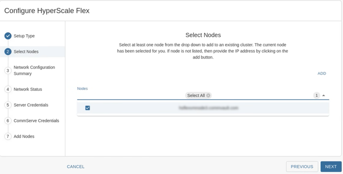

  5. Select the nodes as follows:
    3. Click NEXT.
    4. Click NEXT.

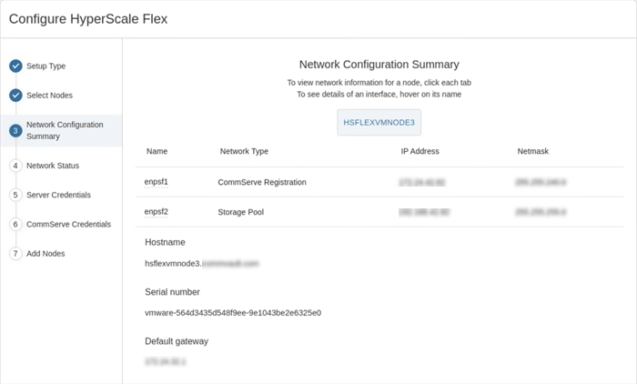

      The Network Configuration Summary page appears. (The following image is for illustrative purposes only. The summary information will vary based on the network configuration and the number of nodes.)
      hs_flex_add_node_3
  6. Verify the summary for each node by clicking the tabs associated with each node. Ensure that the nodes are accurately configured and then click NEXT.
    If an error is found, click Exit, login to the node in which the error is found and repeat all the steps to correct the error. The installation can be continued from that node.

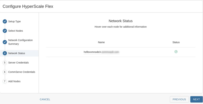

  7. Check the status to ensure that all the nodes have a green status to indicate that the network settings is validated and accurate. Click NEXT.

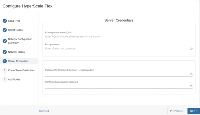

  8. Add the following information:
    1. In the Existing cluster node FQDN box, enter a fully qualified host name of any one of the existing nodes in the storage pool.
    2. In the Root password and Confirm password boxes, type a secure password for the nodes.
      Hover the cursor over the Root password box to view the password requirements. The root password must be the same for all the nodes in the storage pool. Make sure to type the same password.
    3. In the Password for Restricted shell user - cvbackupadmin and Confirm cvbckupadmin password boxes, type a secure password for the cvbackupadmin user.
    4. Click NEXT.

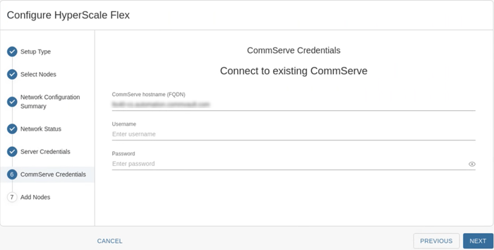

    The Connect to existing CommServe page appears.
    hs_flex_add_node_6
  9. Add the following information:
    1. In the CommServe hostname (FQDN) box, enter the fully qualified host name of the existing CommServe server that you are connecting to.
    2. In the Username and Password boxes, enter the credentials that must be used to access the CommServe server.
    3. Click NEXT.

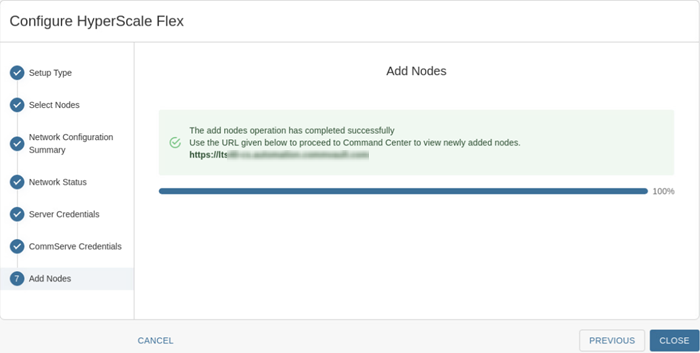

    The installer validates the information and will start the installation process. This process may take some time (approximately 45 minutes) to complete. You can monitor the progress using the progress bar.
    Once the installation is completed, the Add Nodes page appears.
    hs_flex_add_node_7
  10. Click CLOSE.
