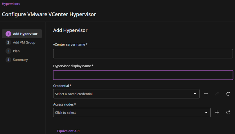

Add a vCenter server
configure-vmware-vcenter-hypervisor
  1. Enter the hostname or IP address of the vCenter server.
    Use a non-default vCenter port
    If your vCenter server uses a non-default port, append the port number to the host name. For example, vc.example.com:1500.
  2. Create credentials with the username and password for the vCenter user account that has the role you created in Create VMware permissions for Commvault using a PowerShell script.
  3. For Access nodes, select Automatic.
    If your environment has multiple networks or if you need to control where backup data is transferred from, select a specific access node.
    You can also add a Windows or Linux access node. For information about access nodes, see Understand and create access nodes.
    If you might need to restore VMs when vCenter is unavailable (for example, restoring the vCenter VM), make sure you can access a restore destination without vCenter, such as a reachable ESXi host.
  4. If a certificate warning appears for vCenter, enable the Skip SSL/TLS certificate verification toggle key only if you trust the vCenter endpoint and understand the security impact.
