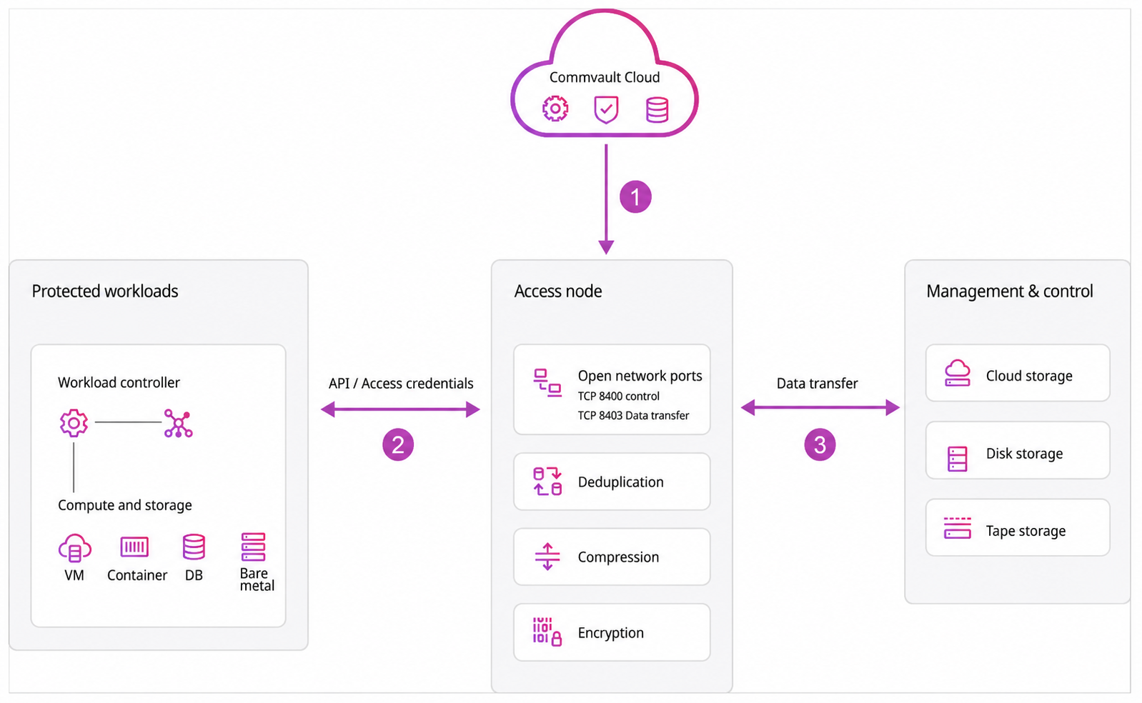

Connectivity flow for backups
During backups, data typically flows outward from your workloads.
Flow:
  1. The access node initiates a connection to the workload.
  2. The access node sends control traffic to Commvault services over HTTPS (TCP 443).
  3. Backup data is transferred to cloud storage.
Key characteristics:
  • Connections are primarily outbound
  • Backup data flows from workloads to storage
  • No inbound connections are required in most cases
Flow:
  1. The client communicates with the MediaAgent over TCP 8400
  2. The MediaAgent coordinates backup operations
  3. Backup data is written to storage using configured data ports
  • Clients typically initiate communication
  • Data flows from client → MediaAgent → storage
  • Additional ports might be used for data transfer

Access node connectivity
  • If you configure an access node, open these ports:
    • TCP 8400: Control communication between the access node and workloads
    • TCP 8403: Data transfer between the access node and workloads
