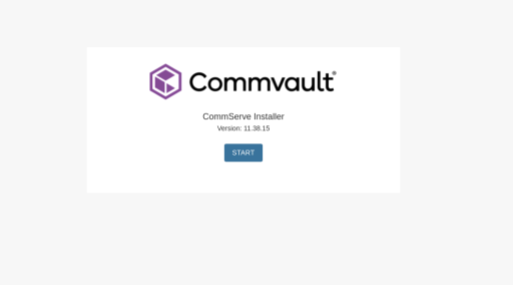

    The CommServe Installer page appears.
    cs_baremetal_install1
  3. Click Start.
    cs_baremetal_install2

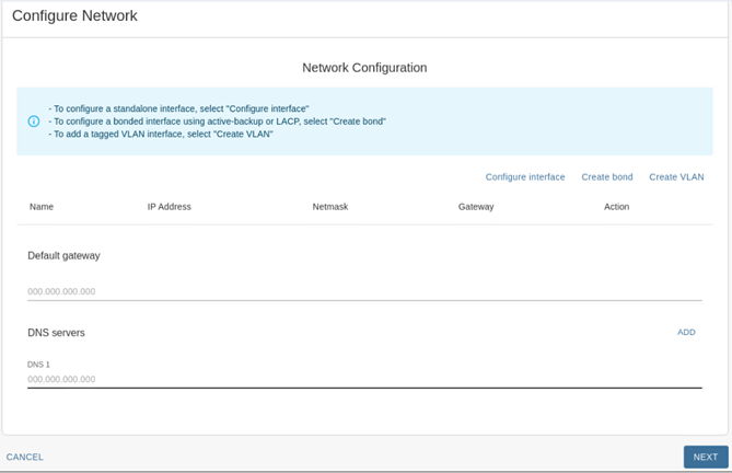

  4. Create a data protection interface bond as follows:
    1. Click Create bond.
    2. From the Interfaces list, select the data protection interfaces. (enpsf3 or enpsf5)
    3. From Bonding mode list, select either active-backup (Mode 1) or LACP (Mode 4).
    4. Click CREATE.
    cs_baremetal_install_bond

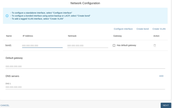

  5. Configure the DNS server(s) as follows:
      If the IP address of the interface belongs to the same subnet as the specified gateway, then the Has Default Gateway check box is automatically selected.
  6. Click NEXT
    robo_linux_bond_install_bond5

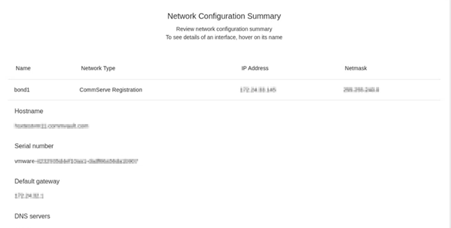

  7. Verify the network configuration and then click PROCEED.

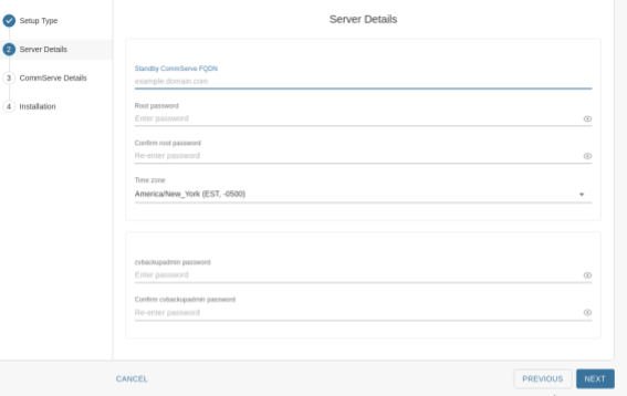

    The Server Details dialog box appears.
    cs_baremetal_install5

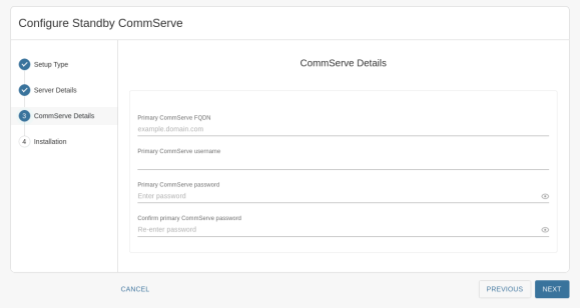

  10. Add the following information:
    1. In the CommServe FQDN box, type type the fully qualified domain name of the CommServe node.
    2. In the Root password and Confirm password boxes, type a secure password for the node.
      If you are installing a Standby CommServe, enter the domain name and root password credentials for the primary CommServe.
      cs_baremetal_install8
    3. From the Time zone list, select the time zone in which the node is located.
    5. Click NEXT.

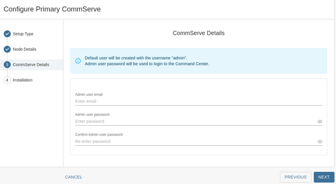

    The CommServe Details page appears.
    cs_baremetal_install6
    A default username admin is created to log on to the Command Center.
  11. Add the following information:
    1. In the Admin user email box, enter the email address for the admin user.
    2. In the Admin user password and Confirm Admin user password boxes, enter the credentials for the admin user.
    3. Click NEXT.

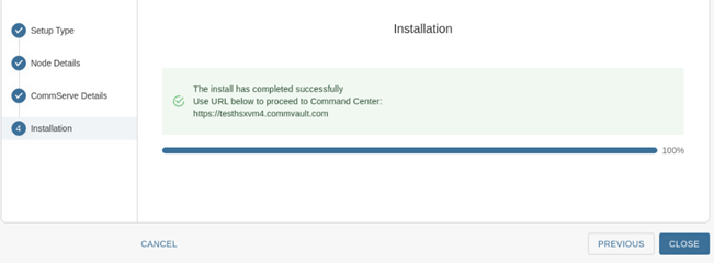

    The software validates the information and will start the installation process. This process may take some time (approximately 30 minutes) to complete. You can monitor the progress using the progress bar.
    cs_baremetal_install7
  12. Click CLOSE.
If the standby CommServe fails to install due to wrong credential or any other reason, delete the content Catalog and Share folder under /csinstall path on the server, and then restart the installation by running the hssetup command.
