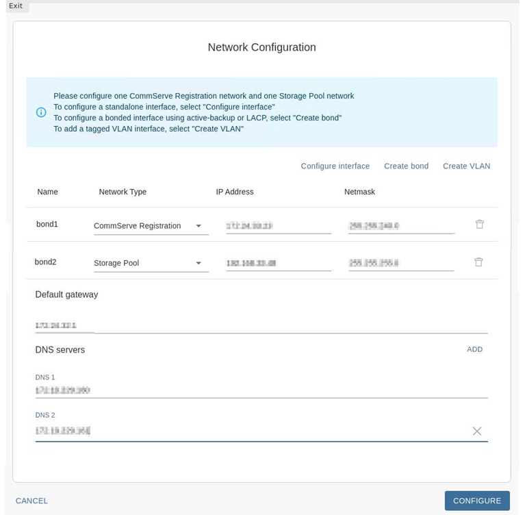

  4. Create a data protection interface bond as follows:
    1. Click Create bond.
      Tagged vLAN and Bonding (30)
    2. From the Interfaces list, select the data protection interfaces. (enpsf3 or enpsf5)
    3. From Bonding mode list, select either active-backup (Mode 1) or LACP (Mode 4).
    4. Click CREATE.
      Tagged vLAN and Bonding (17)
    5. From the Network Type list, select CommServe Registration
    6. Add the IP Address and Netmask in the respective boxes.

  5. Configure the storage pool interface (bonded) as follows:
      Tagged vLAN and Bonding (31)
    2. From the Interfaces list, select the 2 interfaces that will form the storage pool bond. (For example, enpsf4 and enpsf6 .)
    4. Click CREATE.
    5. From the Network Type list, select Storage Pool. This interface will be used exclusively for communication and replication between the HyperScale nodes.

    3. Click CONFIGURE.

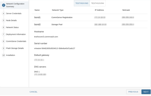

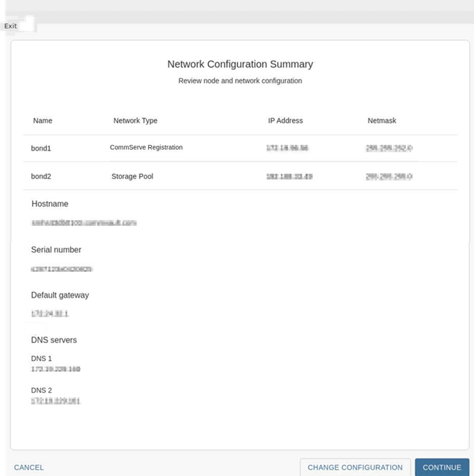

  7. Verify the network configuration and then click CONTINUE. Verify the following information.
    • IP address and netmask for the data protection interface is accurate.
    Tagged VLAN (7)

  11. Verify the summary for each node by clicking the tab associated with each node. Ensure that the nodes are accurately configured and then click NEXT.
    Important
    If an error is found, click Exit, log on to the node in which the error is found and repeat all the steps to correct the error.

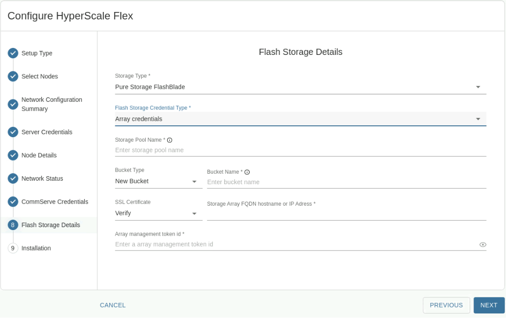

  17. For VAST Data Storage and Pure Storage, the page layout appears differently.

    • If you use Pure Storage, complete the following steps:
      1. From Storage Type list, select Pure Storage FlashBlade.
      2. From the Flash Storage Credential Type list, select Array credentials.
      3. In the Storage Pool Name box, type a name for the cloud storage pool.
      4. In the Bucket Name box, enter the bucket name.
      5. In the Storage Arry FQDN hostname or IP address, type the hostname of IP address of the cloud storage array.
      6. In the Array Management Token Id box, enter the token ID to access the cloud storage.
      7. Click NEXT.
