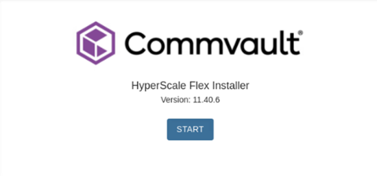

  1. Log on to one of the nodes as root user using the system console as described in Setting up the installation media. (Do not use PuTTy / SSH to setup the nodes.)
    # hssetup
    The HyperScale Flex Installer page appears.
    hs_flex_install1
  3. Click Start.

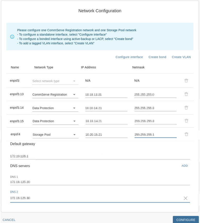

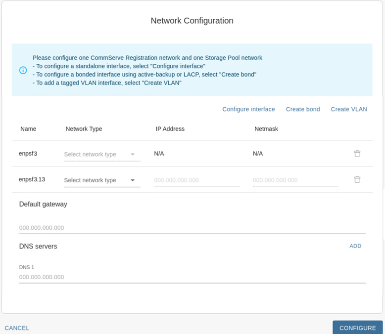

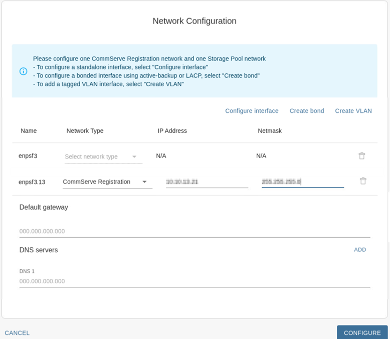

  4. Configure the routable data protection VLAN interface as follows:

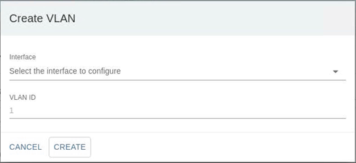

    1. Click Create VLAN.
      The Create VLAN dialog box appears.
      Tagged VLAN (8)
    3. In the VLAN ID box, enter the VLAN ID associated with the routable VLAN network and then click CREATE.
      The interface appears with the VLAN ID in the Network Configuration page. (The VLAN ID will be different, depending on the VLAN ID in your environment.)
      embd_TaggedVLAN1 (5)
      embd_TaggedVLAN1 (6)

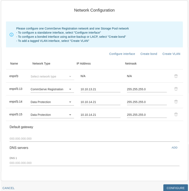

  5. Configure additional data protection VLAN interfaces as follows:
    (Repeat this step to add all the VLANs available in your environment.)
      Tagged VLAN (8)
    3. In the VLAN ID box, enter the VLAN ID associated with the VLAN network and then click CREATE.
    4. From the Network Type list, select Data Protection.
      Repeat this step to configure ALL the VLANs available in your environment.
      Once completed your screen should be similar to the one shown in the following image: (The VLAN IDs and the number of VLANs will be different, depending on the VLAN configuration in your environment.)
    embd_TaggedVLAN1 (7)
  6. Configure the storage pool interface as follows:
    1. Click Configure interface.
      Tagged VLAN (2)
    3. Click CREATE.
      The selected interface appears in the Node and Network Configuration page.
    4. From the Network Type list, select Storage Pool. This interface will be used exclusively for communication and replication between the HyperScale nodes.
      embd_TaggedVLAN2 (2)
  7. Configure the DNS server(s) as follows:
      Tagged VLAN (10)
  8. Click CONFIGURE.

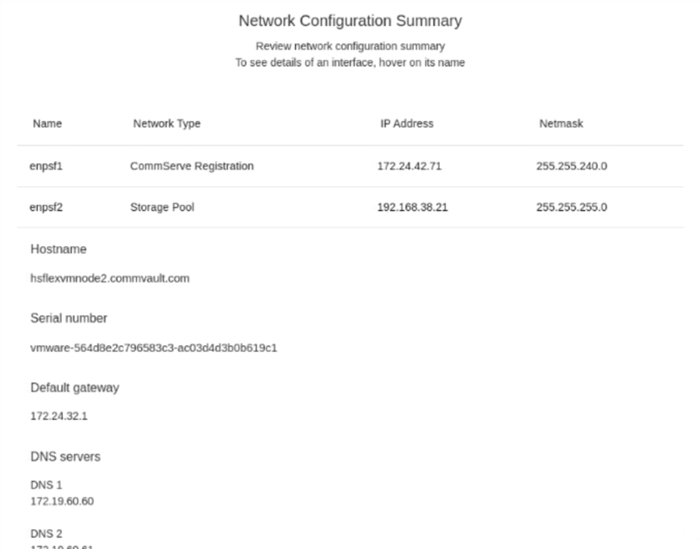

  9. Verify the network configuration and then click CONTINUE.
    • All the VLANs are included.
    • IP address and Netmask for the VLANs are accurate.
      Hostname and serial number associated with the node is accurate.

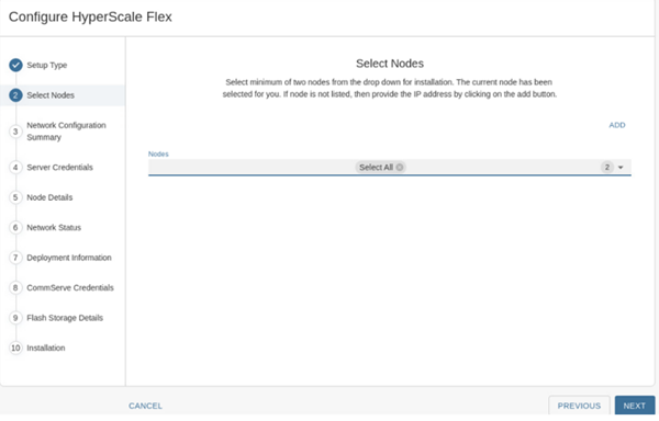

  12. Select the nodes as follows:
    3. Click NEXT.
    4. Click NEXT.

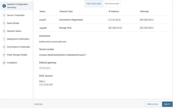

  13. Verify the summary for each node by clicking the tabs associated with each node. Ensure that the nodes are accurately configured and then click NEXT.
    • All nodes have the same number of VLANs.
    • All nodes have identical information for the VLANs.

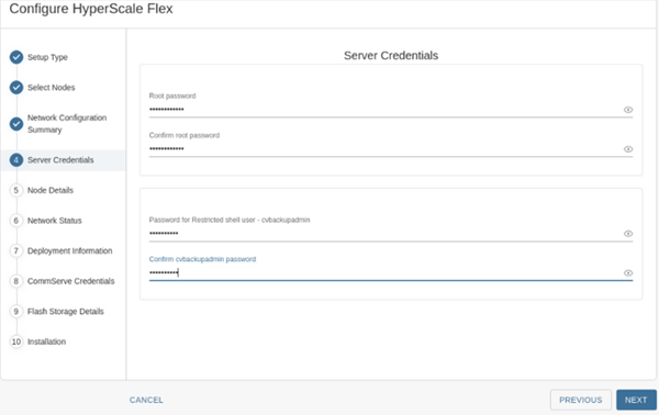

  14. Add the following information:
    2. In the Password for Restricted shell user - cvbackupadmin and Confirm cvbckupadmin password boxes, type a secure password for the cvbackupadmin user.
    3. Click NEXT.

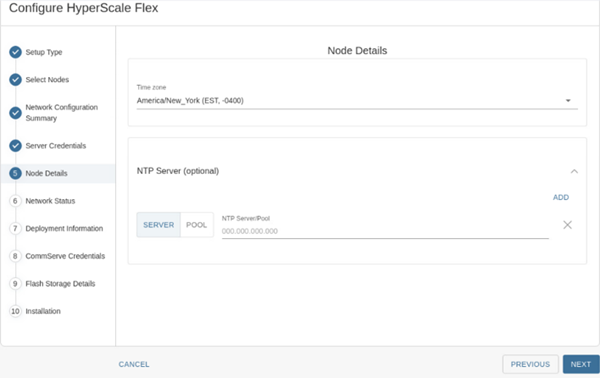

  15. Add the following information:
    1. From the Time zone list, select the time zone in which the nodes are located.
    2. Optional: In the NTP Server/Pool box, type the IP address of the NTP server or NTP pool if available.
    3. Click NEXT.

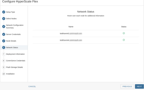

  16. Check the status to ensure that all the nodes have a green status to indicate that the network settings is validated and accurate. Click NEXT.
    The Deployment Information page appears.

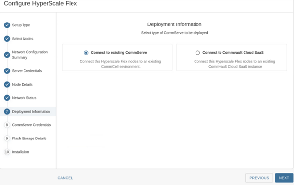

  17. Click Connect to existing CommServe, and then click NEXT.
    The Credentials page appears.
    hs_flex_install_10

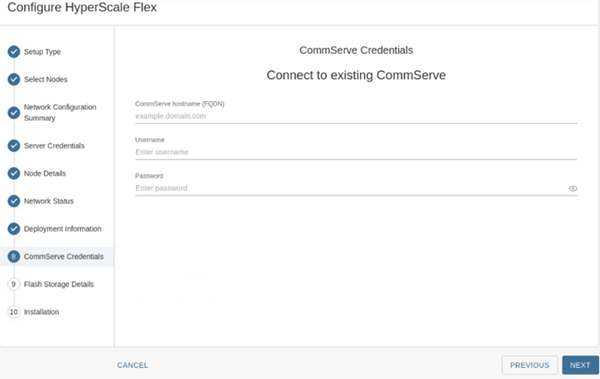

  18. To connect to the CommServe, provide the following details:
    2. In the Username and Password boxes, enter the CommCell user account credentials (not an Active Directory (AD) user account) to connect to the CommServe server, and then click Next.
    The Flash Storage Details screen appears.

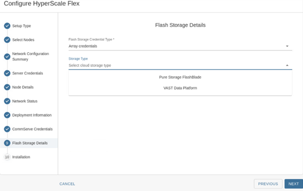

  19. For VAST Data Storage and Pure Storage, the page layout appears differently.

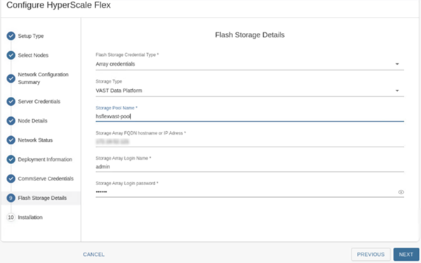

    • If you use VAST Data Storage, complete the following steps:
      1. From the Flash Storage Credential Type list, select Array credentials.
      2. From Storage Type list, select VAST Data Platform.
      3. In the Storage Pool Name box, type a name for the cloud storage pool.
      4. In the Storage Arry FQDN hostname or IP address, type the hostname of IP address of the cloud storage array.
      5. In the Storage Array Login Name box, type the user account to access the cloud storage array.
      6. In the Storage Array Login Password, enter the password for the cloud storage user account.
      7. Click NEXT.

    • If you use Pure Storage, complete the following steps:
      1. From Storage Type list, select Pure Storage FlashBlade.
      2. From the Flash Storage Credential Type list, select Array credentials.
