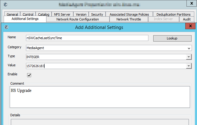

    Alternatively, manually add the following Additional Setting on the Control Node using the CommCell Console:
    The values in setting will not be automatically populated.
    Installing Operating System Updates On Nodes Without Internet Access (1)

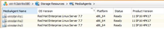

  13. Once the installation is completed, check the status of the installation using the following command:
    ./cvupgradeos.py -status
    This will display a message similar to the following:
                       Upgrade Summary
        hyperscale-hs2                    Successful
        hyperscale-hs3                    Successful
        hyperscale-hs1                    Successful
    [root@hyperscale-hs1 ~]# cat /etc/redhat-release
    Red Hat Enterprise Linux Server release 7.7 (Maipo)
    [root@hyperscale-hs1 ~]# grep Red /boot/grub2/grub.cfg
    menuentry 'Red Hat Enterprise Linux Server (3.10.0-1062.el7.x86_64) 7.7 (Maipo)'
    [root@hyperscale-hs2 ~]# cat /etc/redhat-release
    [root@hyperscale-hs2 ~]# grep Red /boot/grub2/grub.cfg
    [root@hyperscale-hs3 ~]# cat /etc/redhat-release
    [root@hyperscale-hs3 ~]# grep Red /boot/grub2/grub.cfg
    Installing Operating System Updates On Nodes Without Internet Access (2)
