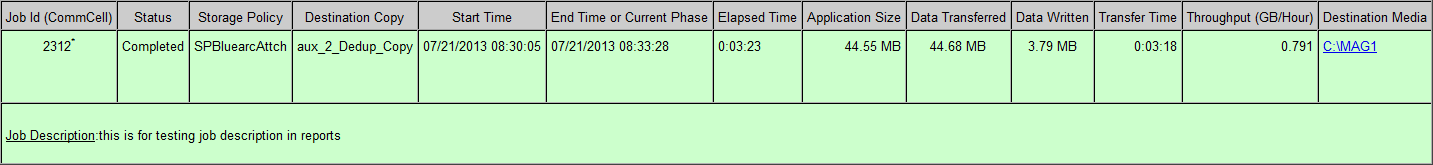

Job Description
When you configure the Jobs with Description option, only jobs that contain the specified description appear in the report. The Job Description section displays the description that the initiating user entered for the job.
aux_copy_job_summary_description

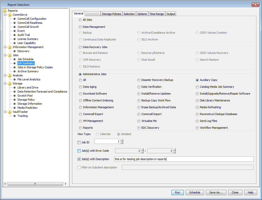

Setting
To display only jobs that contain a particular description, on the General tab, select Jobs with Description, and then enter a description in the box.
aux_copy_job_summary_set_description

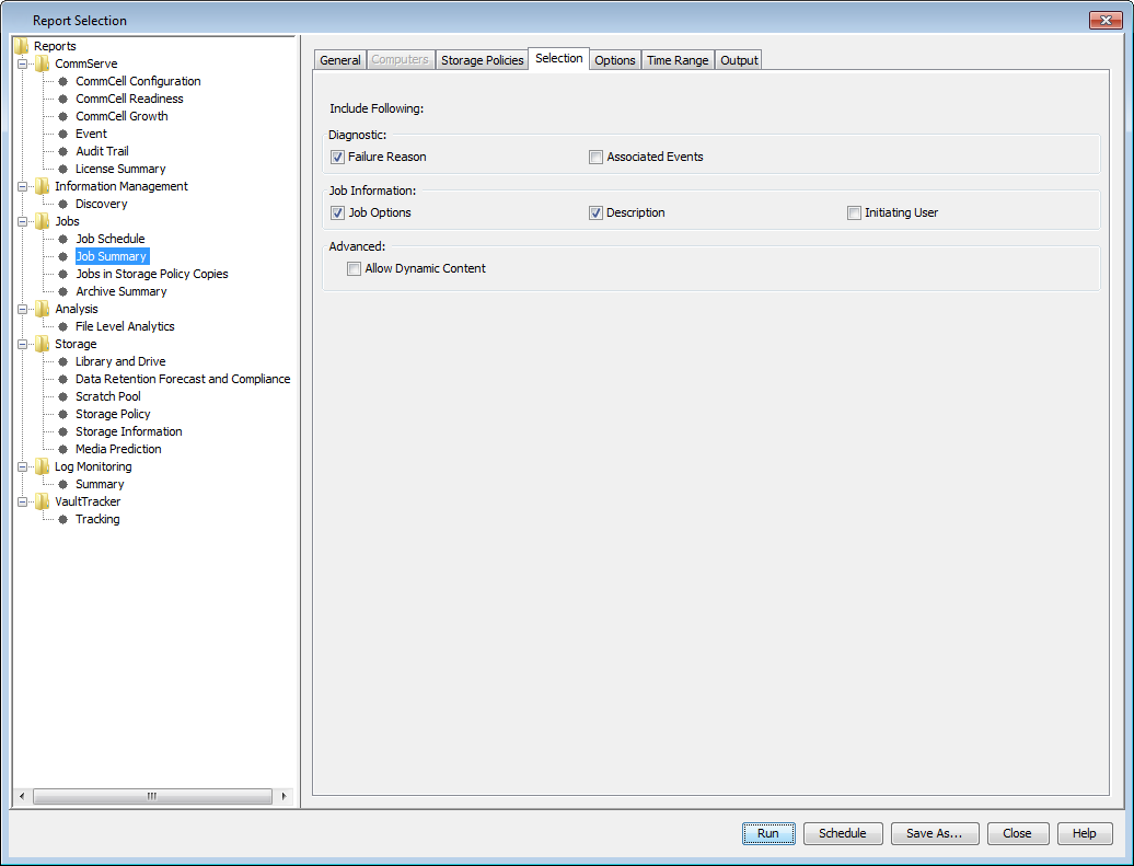

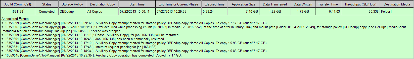

Associated Events
When you select the Associated Events option, any events that are logged as a result of the auxiliary copy job appear in a list under each job.
aux_copy_job_summary_events
Setting
To display the events that are associated with each auxiliary copy job, on the Selection tab, click Associated Events.
aux_copy_job_summary_set_events

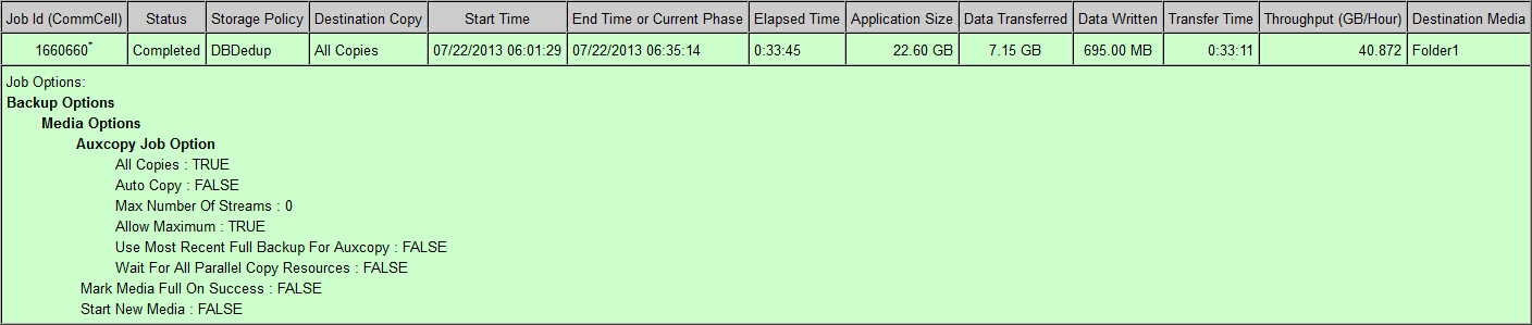

Job Options
When you select Job Options, all of the settings that are configured for a job are listed under the job ID.
aux_copy_job_summary_job_options
Setting
To display the settings for each job, on the Selection tab, click Job Options.
aux_copy_job_summary_set_job_options
Initiating User
When you select the Initiating User option, the user who scheduled or started the job is listed in the Initiating User column.
aux_copy_job_summary_initiating_user
Setting
To display the name of the user who started the job, on the Selection tab, click Initiating User.
aux_copy_job_summary_set_initiating_user
