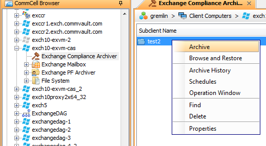

  1. From the CommCell Console, navigate to <Client> | Exchange PF Archiver
  2. Right-click the Subclient and click Archive
    schedule_backup

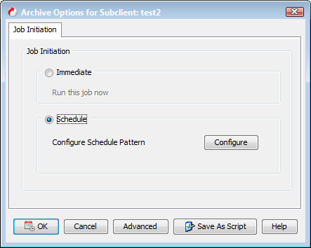

  3. Click Schedule
    Click Configure
    schedule_archive02

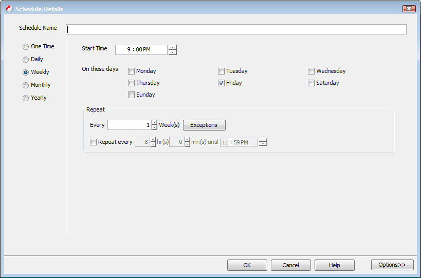

  4. Select Schedule Options. For example:
    • Click Weekly
    • Check the days you want the run the archive job
    • Click OK to close the Schedule Details dialog box
    • Click OK to close the Archive Options dialog box
    The archive job will execute as per the schedule

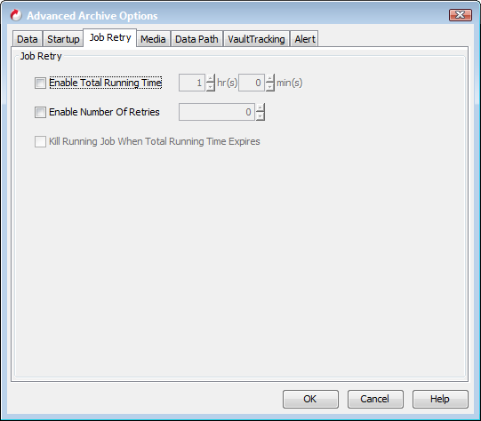

  4. In the Advanced Archive Options dialog box, click the Job Retry tab.
  5. Select Enable Total Running Time and specify the maximum elapsed time before a job can be restarted or killed.
  6. Select Kill Running Jobs When Total Running Time Expires to kill the job after reaching the maximum elapsed time.
  7. Select Enable Number Of Retries and specify the number of retries.
  8. Click OK.

Job Retry Options
  1. The Job Retry option helps in configuring the retry behavior of the archive jobs. You can specify the maximum elapsed time before a job can be restarted or killed and the maximum number of restart attempts. From the CommCell Browser, expand Client Computers > client > agent > backup_set.
  2. Right-click the subclient, and then click Archive.
  3. From the Archive Options dialog box, click Advanced.
  4. Select Job Retry.
  5. Select Enable Total Running Time and specify the maximum elapsed time in hours and minutes.
  6. Select Number Of Retries and specify the number of retries. Based on this number, the Job Manager attempts to restart the job.
  7. Select Kill Running Jobs When Total Running Time Expires. The job will be killed when the job is still in running status even after reaching the maximum elapsed time.
  8. Click OK.
