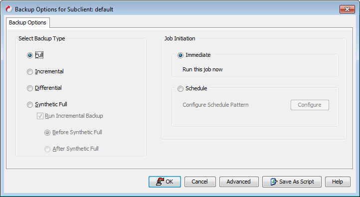

Full backups provide the most comprehensive protection of data.
  1. From the CommCell Console, expand client > Exchange Public Folder > backup_set.
  2. Right-click the subclient and click Backup.
  3. Select Full as backup type and Immediate to run the job immediately.
  4. Click OK.
    You can track the progress of the job from the Job Controller or Event Viewer window.

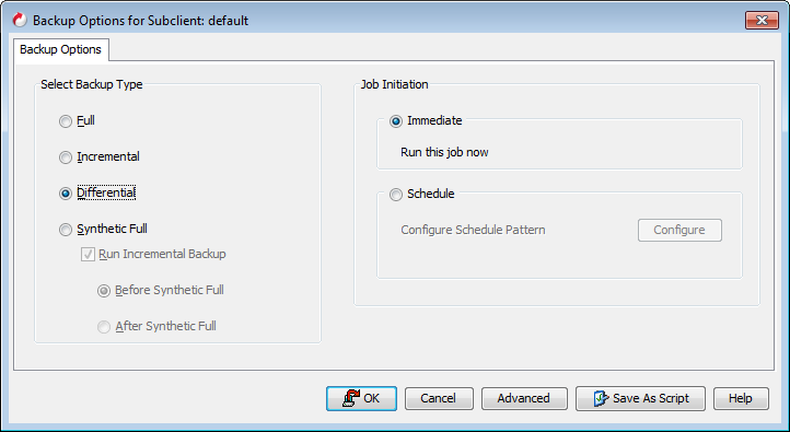

A differential backup contains only the data that is new or has changed since the last full backup. Like incremental backups, differential backups also consume less media and use less resources than full backups. Differential backups are cumulative. This means that each differential backup contains all changes accumulated since the last full backup. Each successive differential backup contains all the changes from the previous differential backup.
  2. Right click the subclient and click Backup.
  3. From the Backup Options dialog box, select the following options:
    • Backup Type: Differential.
    • Backup Schedule: Immediate
  4. Click OK.
    You can track the progress of the backup job from the Job Controller window.
    When the backup has completed, the Job Controller displays Completed.
