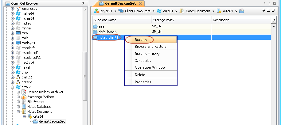

  1. From the CommCell Console navigate to Client Computers | <Client> | Notes Document.
    In the right-pane, right-click the <Subclient> and click Backup.
    backup_subclient

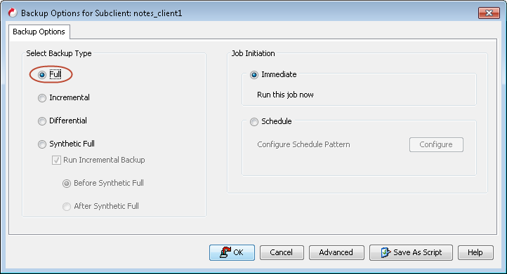

  2. Ensure under Select Backup Type, Full is selected.
    Under Job Initiation, Immediate is selected.
    Click Ok.
    select_backup_type

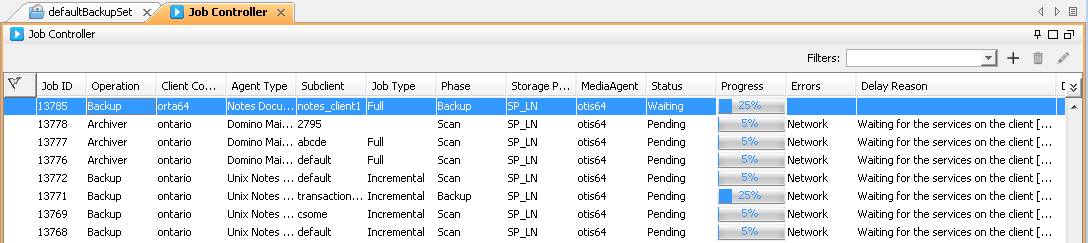

  3. In the Job Controller tab, track the process of your backup job.
    Wait until the job has completed before you perform the next steps.
    job_controller - backupklzzwxh:0022otus_notes_docklzzwxh:0023ob_controller.png

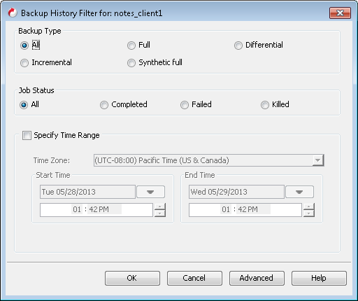

  4. In the defaultBackupSet tab, right-click <Subclient>, and then click Backup History.
    view_backup_history - backupklzzwxh:0031otus_notes_docklzzwxh:0032iew_backup_history.png\
  5. In the Backup History Filter dialog box, click OK.
    filter_backup_history

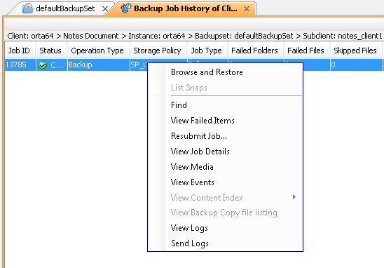

  6. In the Backup History tab, right-click the backup job to view the following job details:
    • Items that failed during the job
    • Items that succeeded during the job
    • Details of the job
    • Events of the job
    • Log files of the job
    • Media associated with the job
    view_history_details
