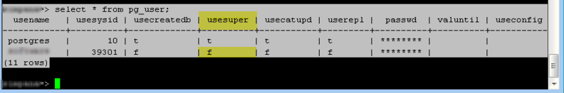

Here, the user provided in the instance creation dialog box doesn't have the necessary usesuper or superuser attribute.
Resolution 3
Use the following steps to add the superuser attribute to the user:
  1. Once connected to PostgreSQL, run the following query to check if the usesuper attribute is incorrectly set:
    select * from pg_user;
    alter_user
    In the screenshot above, the commvault user has a f set against usesuper attribute. Instance creation using this user will therefore generate the above error.
  2. When connected to PostgreSQL as superuser, run the following query to add the attribute:
    PGSQL> ALTER USER username WITH superuser;
  3. Run the following query again to check if the attribute now shows a t against usesuper attribute.
