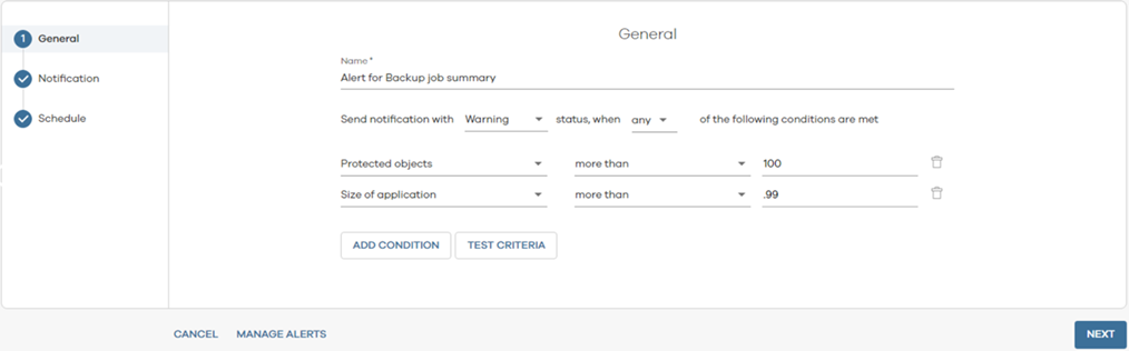

  4. Under General, in the Name box, type a name for the alert.
  5. To specify a severity for the alert, such as Warning or Critical, next to Send Notification With, select a status from the list.
  6. To set an alert based on the information in a column, select the column name, select a condition, and then type a value in the box.
    Values are not case sensitive.
    For example:
    Select Protected Objects, select more than, and then type 100.
  7. To add more alerts based on information in columns, click Add Condition, specify the column name and value, and then choose when to send notifications.
  8. To check the alert conditions you configured, click Test Criteria.
    The results appear in a new tab in your web browser.
    alert general setting

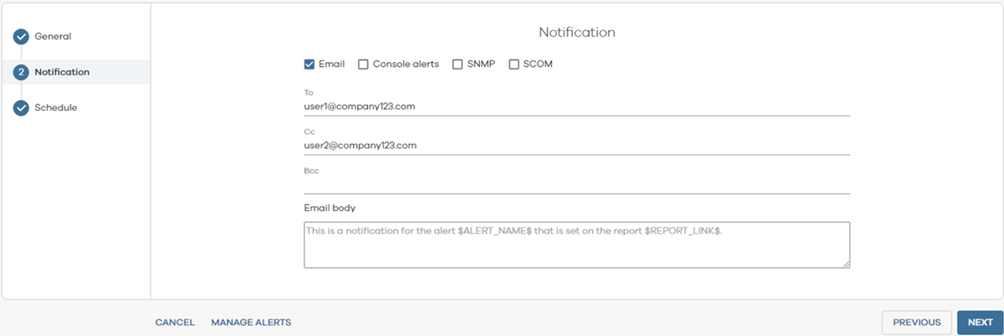

  10. Under Notification, specify the methods for sending alerts:
    • To send the alert in an email, select Email, and in the To, Cc, and Bcc box, type email addresses, and then enter any additional email text in the Email body box.
    • To send the alert through the CommCell Console alerts system, select Console alerts.
    • To send the alert using the Windows Event Viewer, select Windows event viewer, and then in the Description box, configure the alert message.
    The Event Viewer option cannot be configured for Linux CommServe computer.
    For more information on the alert types, see Alert Types.
    alert notification setting

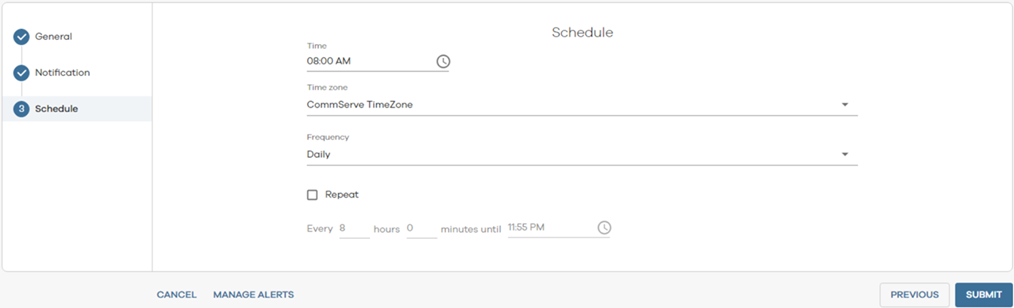

  12. Under Schedule, in the Time box, select a time.
  13. In the Time Zone drop-down list, select a time zone.
  14. In the Frequency box, select the frequency for sending the alert, such as daily or weekly.
  15. To configure the notification to repeat, select the Repeat check box, select an hour and minute, and in the until box, select a time.
    alert schedule setting
