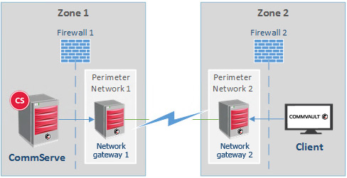

The network gateways are configured between CommCell entities, such as the CommServe computer and client displayed in the following diagram:
Configuring a Cascading Network Gateway Topology (1)
Use this procedure to configure incoming and outgoing connections on the four CommCell entities that are shown in the diagram: CommServe computer, Network gateway 1, Network gateway 2, and Client.
Although the diagram and procedure describe a CommServe computer and a client, the two CommCell entities can be any combination of CommServe computer, MediaAgent, and client.
The Commvault network gateway computers must be configured.
Step 1: Configure the CommServe host
Configure the rules for the CommServe computer to block incoming connections from Network gateway 1, and then force outgoing connections through the VPN tunnel to Network gateway 2 through Network gateway 1, and to the client through Network gateway 1.

Step 2: Configure Network gateway 1
Configure the network rules for Network gateway 1 to restrict incoming connections from both the CommServe computer and Network gateway 2, and then force the outgoing connection to the client through Network gateway 2 through the VPN tunnel.

Step 3: Configure Network gateway 2
Configure the network rules for Network gateway 2 to restrict incoming connections from Network gateway 1 and the client, and then force the outgoing connection to the CommServe computer through Network gateway 1.

Step 4: Configure the client
Configure the client’s network rules to block incoming connections from Network gateway 2, and then force outgoing connections through the VPN tunnel to Network gateway 1 through Network gateway 2, and to the CommServe computer through Network gateway 2.
