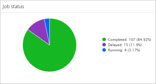

Job Status
This chart displays the number of backup jobs in each status during the specified time period. The percentage of jobs in each status is also displayed.
The following table defines each job status type.
Status |
Description |
Running |
Jobs that were running at the time of the report. |
Completed |
Jobs that completed during the specified time. |
Delayed |
Jobs that were delayed at the time of the report generation. |
No Run |
Jobs that are scheduled to run, but did not run which are in suspended state. Reasons that scheduled jobs do not run include:
Failed |
Jobs that failed. |
Killed |
Jobs that were killed. |
Completed with Errors |
Jobs that completed with errors. |
Completed with Warnings |
Jobs that completed with warnings. |
Committed |
Jobs that committed during the specified time. For more information about committing jobs, see Committing a Backup Job by Using the Kill Option. |

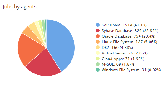

Jobs by Agents
This chart displays the number of agents installed in the CommCell environment.
