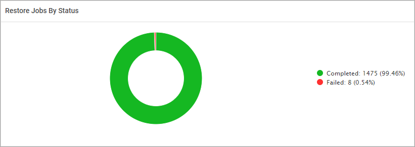

Restore Jobs By Status
This chart displays the number and percentage of restore jobs in each status type, including Completed, Completed with Errors, Failed, and Completed with Warnings.
The following image is an example of the Restore Jobs By Status chart.
