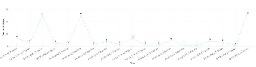

Trend of job failure in previous 24 hours Chart
This chart displays the trend of the failed jobs in the previous 24 hours.

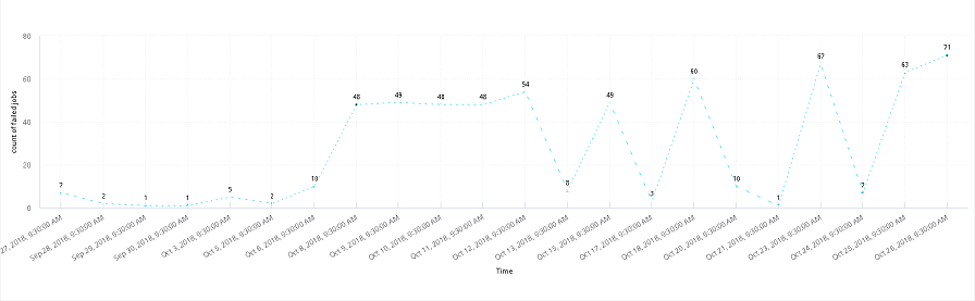

Trend of job failures at same hour in last 30 days Chart
This chart displays the trend of the failed jobs at the same hour in the last 30 days.
