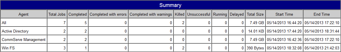

Summary
This table provides summary information about all restore jobs for each agent.
restore_job_summary_table
Column
Agent
The type of agent on which restore jobs ran.
Total Jobs
Total number of jobs that ran on the agent during the specified time.
Completed
Number of jobs that completed during the specified time.
Completed with Errors
Number of jobs that completed with errors.
Completed with Warnings
Number of jobs that completed with warnings.
Killed
Number of jobs that were killed.
Unsuccessful
Number of jobs that failed.
Running
Number of jobs that were running at the time of the report.
Delayed
Number of jobs that were delayed at the time of the report.
Total Size
Total size of all jobs that ran on the agent.
Start Time
The time at which the first job began.
End Time
dThe time at which the last job ended.

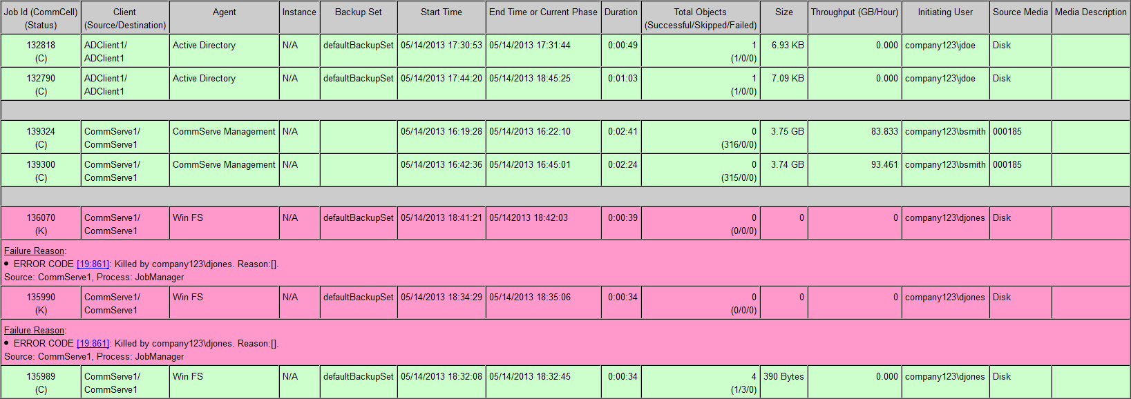

Details
This table provides information about each restore job on each client that matches the selected criteria. The following columns are included by default.
restore_job_summary_details
Column
Job ID (CommCell) (Status)
ID number for the backup job and the status of the backup job.
Client (Source/Destination)
Name of the client computer, or source, on which the backup job is saved and the name of the computer, or destination, to which the backup job was restored.
Agent
Type of agent.
Instance
The particular agent on which the restore job ran.
Backup Set
Name of the backup set on which the restore job ran.
Start Time (Writer Start Time)
Date and time at which the restore job began.
End Time or Current Phase (Write End Time)
Date and time at which the restore job ended.
Duration
The amount of time that it took the restore job to run.
Size
Size of data included in the restore job.
Throughput (GB/Hour) (Current)
The amount of data backed up per hour during the transfer of data from client to media.
Initiating user
The user who scheduled or started the restore job.
Source Media
The type of media on which the source backup job was saved.
Media Description
dDescription of the media.

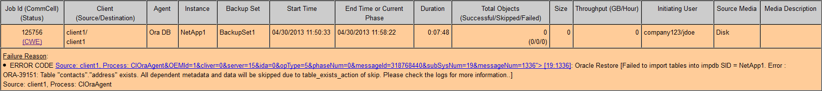

Failure Reason
This section appears for each job that includes an error. Information includes the following:
  • Job error code
  • Description of the error
  • Source and Process related to the error
