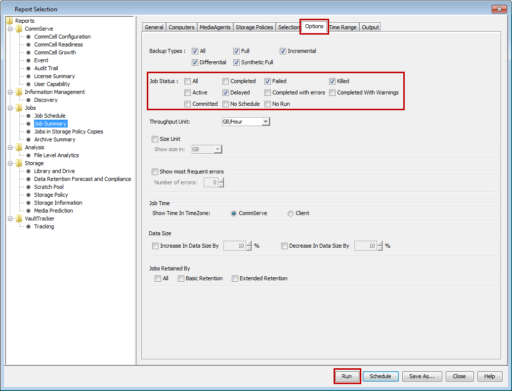

In the Backup Job Summary Report, you can view all of the jobs that a problem running, such as failed, killed, and delayed jobs.
  1. In the CommCell Console, click the Reports tab, and then click the Summary button.
  2. Under Reports, select Job Summary.
  3. On the General tab, click Data Management, and then click Backup
  4. Click the Options tab.
  5. Next to Job Status, clear the All option, and then select Failed, Killed, and Delayed.
  6. Click Run.
    js_bu_problem_jobs
    The report appears in the output format that you specified.
