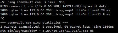

Linux Computers
From the client computer, ping the MediaAgent host using the following command:
Ping Hostname or IP address -s Length of data to send -Mdo
Where:
-s = Length of data to send (in bytes). This equals the Layer 2 MTU size minus the ICMP header (8 bytes) minus the IP header (20 bytes)
-Mdo = Send "don’t fragment" (DF) bit
Example 1:
In the following example, using a Layer 2 MTU size of 1500, there are no discarded packets.
FAQ - How do I know whether my network supports the MTU I want to use? (3)

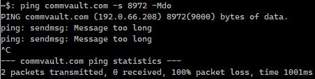

Example 2:
In the following example, using a Layer 2 MTU size of 9000, there are discarded packets.
FAQ - How do I know whether my network supports the MTU I want to use? (4)
