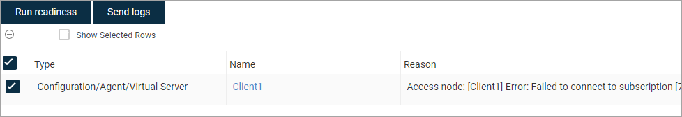

    • To send logs for a single entity, select an entity, and then at the top of the Failure table, click Send Logs.
      commcell_readiness_send_log_for_multiple_entity

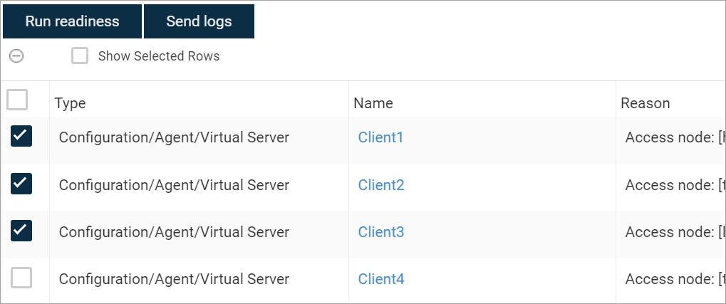

    • To send logs for multiple entities, select a group of entities, and then at the top of the Failure table, click Send Logs.
      commcell_readiness_send_log_for_single_entity
    The Send log files page appears.
