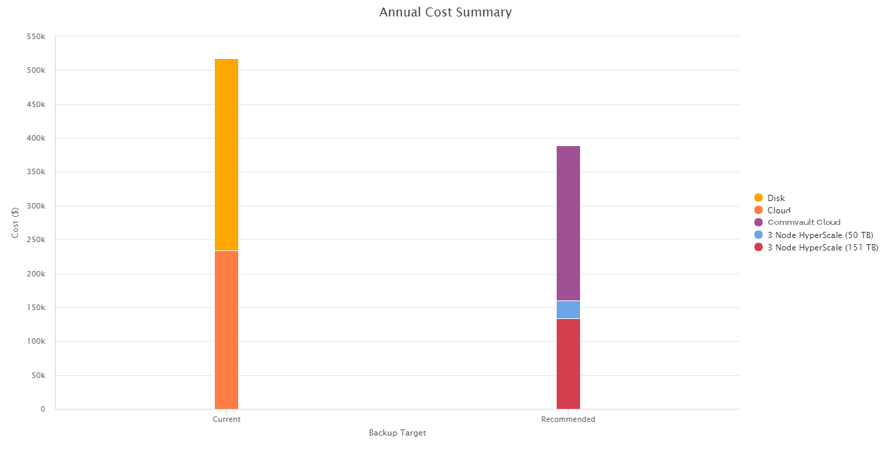

Annual Cost Summary
This chart presents the following information:
The total costs for the different backup storage target types that you use currently.
The total expected costs for the backup storage target types that Commvault recommends using.
