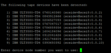

  3. Press Enter to initiate the SCSI bus scan.
    A list of detected tape devices appears.
    Example output:

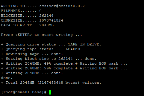

Writing Data
Use the Write option with scratch tape media, because it might overwrite any tape media that is currently active with valid data.
  1. Type the number of the device node that you want to write data to, and then press Enter.
  2. Type 2 to write data to the selected tape directory.
  3. Type the file marker to reposition the tape before starting to write.
  4. Type 0 to write the entire data in a single chunk.
  5. Type the chunk size in MB.
  6. Type the number of MB to write, and then press Enter to start writing.
  7. Press Enter to continue.
    Example output:

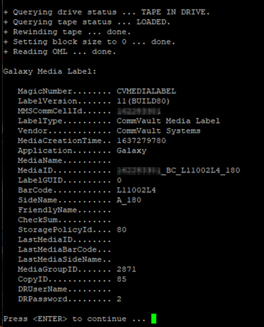

Displaying On Media Label (OML)
  1. Type 3 to read and display the OML.
  2. Press Enter to continue.
    Example output:
