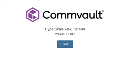

    # hssetup
    The HyperScale Flex Installer page appears.
    hs_flex_install1
  3. Click Start.

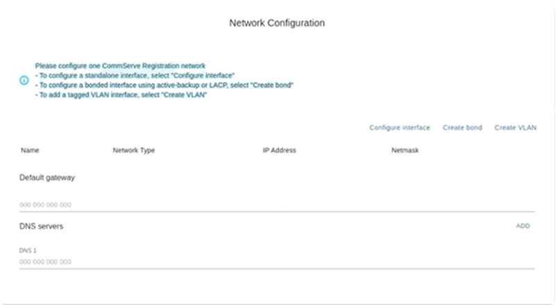

  4. Configure the data protection interface as follows:
    1. Click Configure interface.
      Tagged VLAN (2)
    2. From the Interfaces list, select one of the data protection interfaces. (For example, enpsf1 or enpsf3.)
    3. Click CREATE.
    4. From the Network Type list, select CommServe Registration
  5. Configure the storage pool interface as follows:
      Tagged VLAN (2)
    3. Click CREATE.

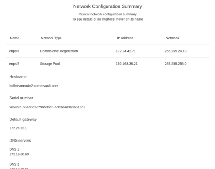

      The selected interface appears in the Node and Network Configuration page.
    4. From the Network Type list, select Storage Pool. This interface will be used exclusively for communication and replication between the HyperScale nodes.

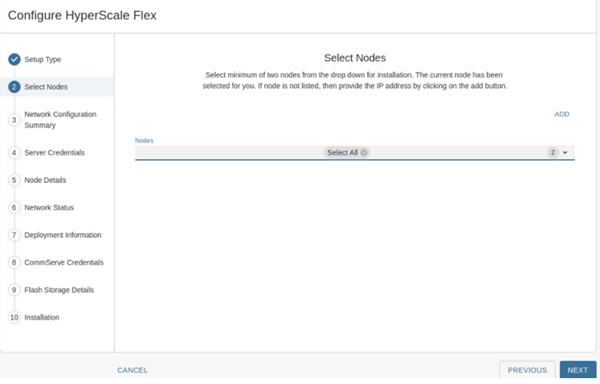

      The Setup Type page appears.
      hs_flex_install_3
    hs_flex_install_4
    3. Click NEXT.
    4. Click NEXT.

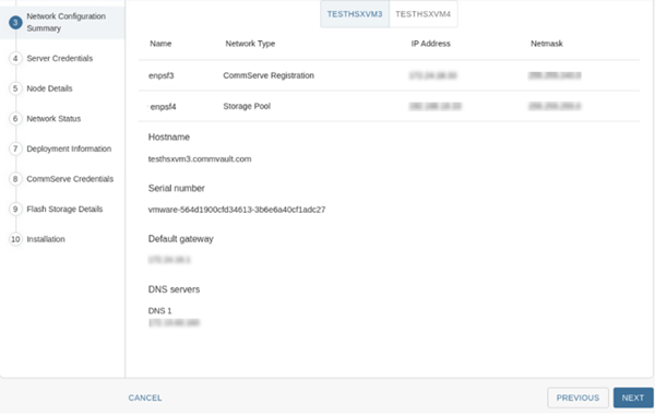

  12. Verify the summary for each node by clicking the tab associated with each node. Ensure that the nodes are accurately configured and then click NEXT.
    Important
    If an error is found, click Exit, log on to the node in which the error is found and repeat all the steps to correct the error.

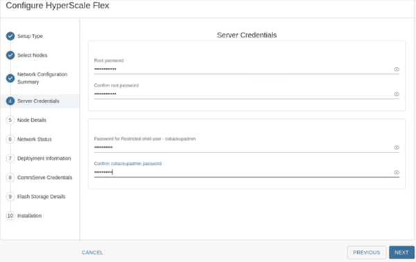

    2. In the Password for Restricted shell user - cvbackupadmin and Confirm cvbckupadmin password boxes, type a secure password for the cvbackupadmin user.
    3. Click NEXT.

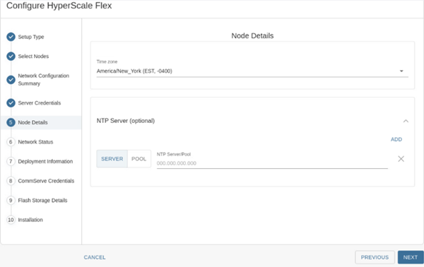

  14. Add the following information:
    1. From the Time zone list, select the time zone in which the nodes are located.
    2. Optional: In the NTP Server/Pool box, type the IP address of the NTP server or NTP pool if available.
    3. Click NEXT.

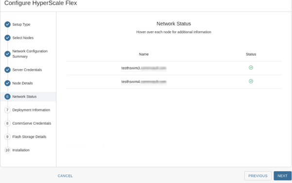

  15. Check the status to ensure that all the nodes have a green status to indicate that the network settings is validated and accurate. Click NEXT.

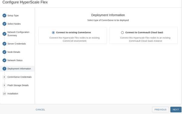

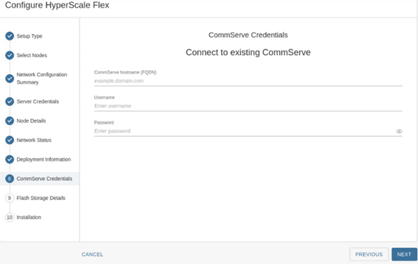

  16. Click Connect to existing CommServe, and then click NEXT.
    The Credentials page appears.
    hs_flex_install_10
  17. To connect to the CommServe, provide the following details:
    2. In the Username and Password boxes, enter the CommCell user account credentials (not an Active Directory (AD) user account) to connect to the CommServe server, and then click Next.

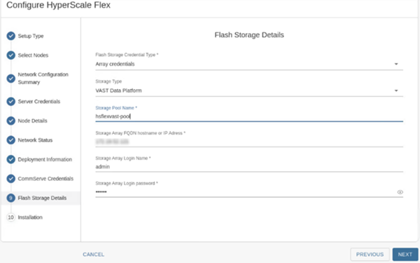

    hs_flex_install_11

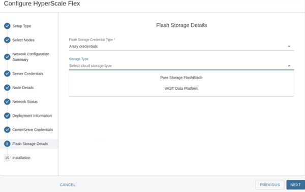

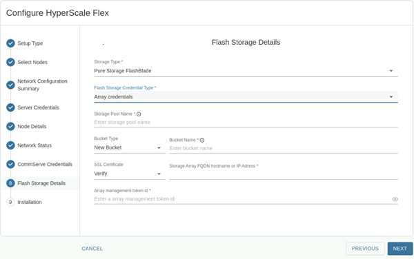

  18. For VAST Data Storage and Pure Storage, the page layout appears differently.
    • If you use VAST Data Storage, complete the following steps:
      1. From the Flash Storage Credential Type list, select Array credentials.
      2. From Storage Type list, select VAST Data Platform.
      3. In the Storage Pool Name box, type a name for the cloud storage pool.
      4. In the Storage Arry FQDN hostname or IP address, type the hostname of IP address of the cloud storage array.
      5. In the Storage Array Login Name box, type the user account to access the cloud storage array.
      6. In the Storage Array Login Password, enter the password for the cloud storage user account.
      7. Click NEXT.
      hs_flex_install_12
    • If you use Pure Storage, complete the following steps:
      1. From Storage Type list, select Pure Storage FlashBlade.
      2. From the Flash Storage Credential Type list, select Array credentials.
      4. In the Bucket Name box, enter the bucket name.
      5. In the Storage Array FQDN hostname or IP address, type the hostname of IP address of the cloud storage array.
      6. In the Array Management Token Id box, enter the token ID to access the cloud storage.
      7. Click NEXT.
      hs_flex_install_12
