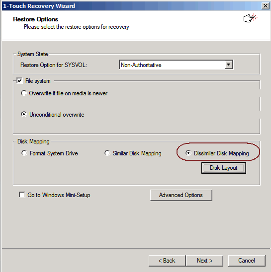

  15. Select Dissimilar Disk Mapping. For more information, see Disk Mapping Options.
  16. Manually clean and create system disk. Do not format shared or quorum disk.
  17. Complete the Interactive Restore.
