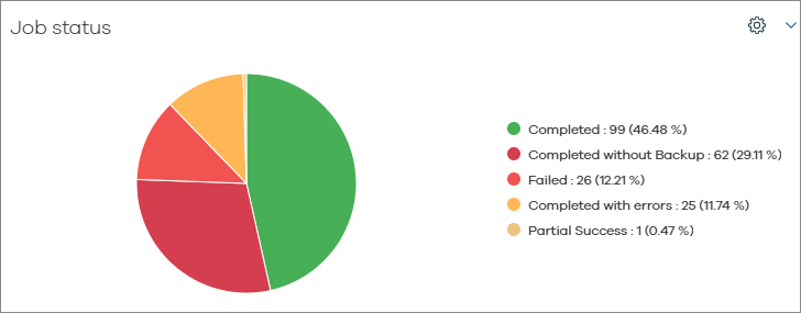

Job Status
This chart (sample shown below) displays the number of backup jobs in each status during the specified time period. The percentage of jobs in each status is also displayed.
The following table defines each job status type.

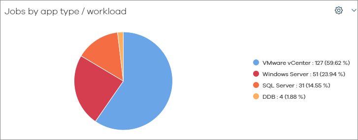

Jobs by App Type/Workload
This chart (sample shown below) displays the number of backup jobs by app type/workload during the specified time period. The percentage of jobs by app type is also displayed.
