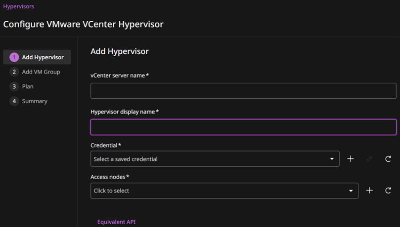

Add a vCenter server
configure-vmware-vcenter-hypervisor
  1. Enter the hostname or IP address of the vCenter server.
    Use a non-default vCenter port
    If your vCenter server uses a non-default port, append the port number to the host name. For example, vc.example.com:1500.
  2. Create credentials with the username and password for the vCenter user account that has the role you created in Create VMware permissions for Commvault using a PowerShell script.
  3. For Access nodes, select Automatic or a specific access node.
    For guidance, see Plan for VMware vSphere protection.
    For instructions, see Deploy an access node for VMware vSphere.
    If no access node is available to select, click the add button to create one.
  4. If a certificate warning appears for vCenter, enable the Skip SSL/TLS certificate verification toggle key only if you trust the vCenter endpoint and understand the security impact.
    Linux access node certificate validation
    If you use a Linux access node, certificate validation can fail intermittently when the certificate issuer is not trusted by the Linux OS certificate store.
    To resolve this issue, add the certificate to /etc/ssl/certs/ca-bundle.crt, run cert-sync /etc/ssl/certs/ca-bundle.crt, and retry the VMware vSphere hypervisor configuration.
