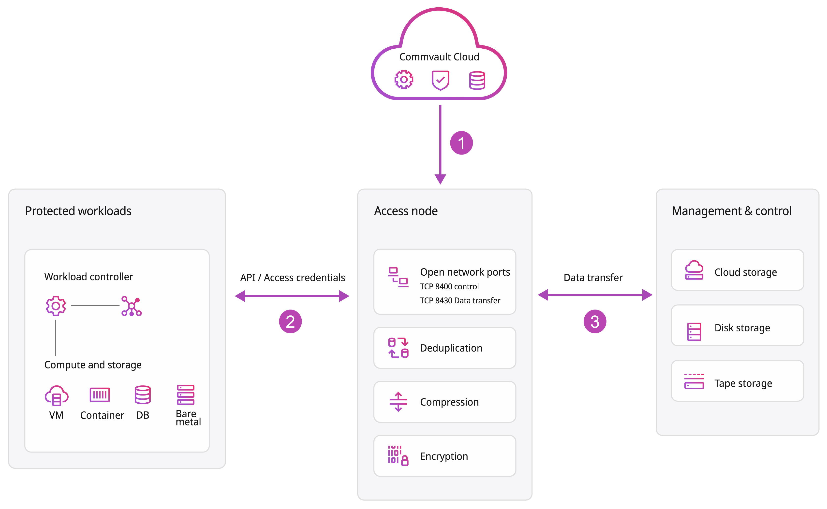

The following diagram shows baseline connectivity requirements for Commvault.
network-connections-get-started-with-cv
Access nodes initiate outbound connections to Commvault services, protected workloads, and backup storage.
Callout Connection Ports
1 Access node → Commvault services • HTTPS (TCP 443)
• DNS (TCP/UDP 53)
2 Access node → Protected workloads Workload examples:
• Active Directory: LDAP (TCP 389), LDAPS (TCP 636)
• VMware vSphere: HTTPS (TCP 443), data port (TCP 902)
• SQL Server: TCP 1433
• PostgreSQL: TCP 5432
• Azure VM: HTTPS (TCP 443)
• NAS: SMB TCP 445, NFS TCP 2049
3 Access node → Backup storage Storage examples:
• Cloud storage: HTTPS (TCP 443)
• SMB storage: TCP 445
• NFS storage: TCP 2049
If outbound TCP 443 is already open in your environment, most Commvault SaaS deployments are ready to proceed.
