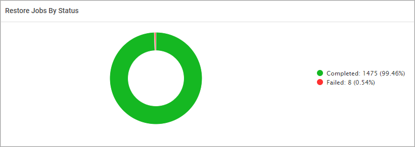

Restore Jobs By Status
This chart displays the number and percentage of restore jobs in each status type, including Completed, Completed with Errors, Failed, and Completed with Warnings.
The following image is an example of the Restore Jobs By Status chart.
restore_job_by_status_FR30

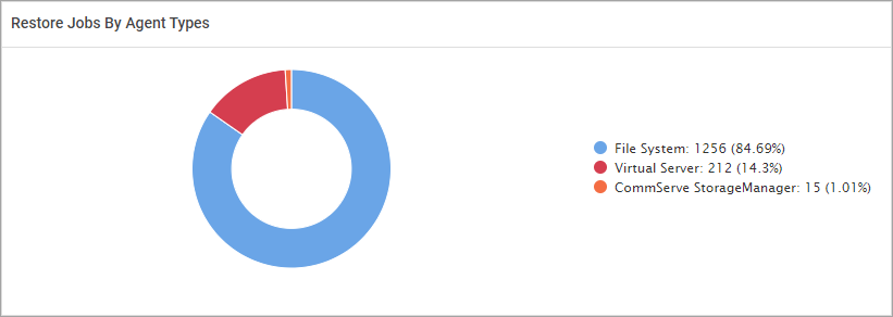

Restore Jobs By Agent Types
This chart displays the number and percentage of restore jobs that ran for each agent type in the CommCell environment.
The following image is an example of the Restore Jobs By Agent Types.
restore_job_by_agent_types_FR30
