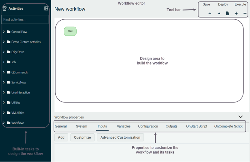

    The workflow editor opens in a new browser tab, with the Start activity in the design area.
    Workflow Editor Window
  4. Click the white space in the design area.
    The workflow properties appear at the bottom of the design area.

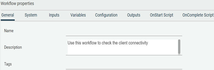

  1. On the General tab, complete the following:
    • In the Name box, enter a name for the workflow.
    • In the Description box, enter a brief description about the workflow.

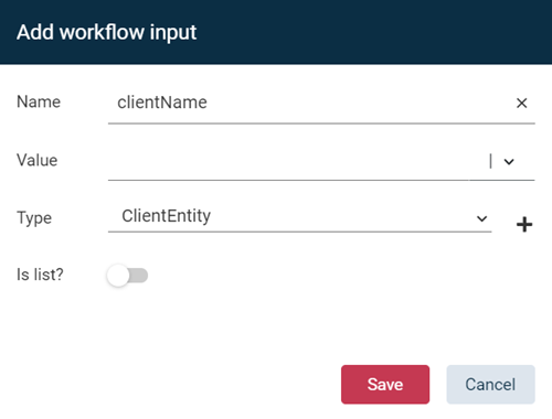

  2. On the Inputs tab, define a variable for the client name:
    1. Click Add.
      The Add workflow input dialog box appears.
    2. In the Name box, enter clientName.
    3. Beside the Type list, click +.
      The Select Type dialog box appears.
    4. Expand CvEntities, and then select ClientEntity.
    5. Click OK.
    6. Click Save.

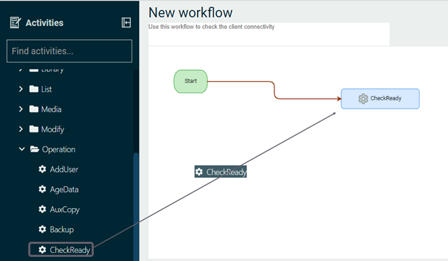

Set Up the CheckReady Activity
  1. From the Activities pane, go to QCommands > Operations.
  2. Select and drag the CheckReady activity into the design area.
    Drag CheckReady Activity
    This activity runs the qoperation checkready command.
  3. Select the CheckReady activity.
    The properties for the CheckReady activity appear at the bottom of the design area.

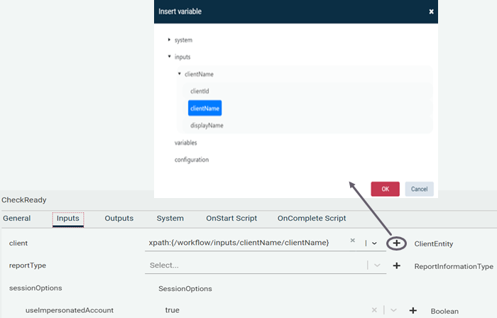

  5. On the Inputs tab, complete the following:
    1. Beside client, click +.
      The Insert variable dialog box appears.
    2. Go to system > workflowEngine, and then select clientName.
      CheckReady Insert Variable

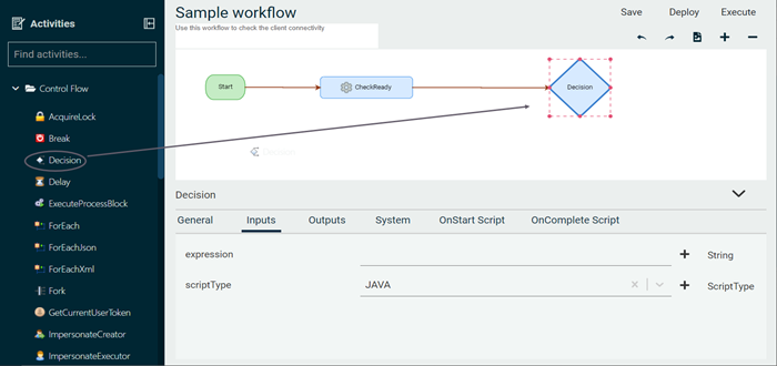

Configure the Decision Activity
  1. From the Activities pane, go to Control Flow > Decision.
  2. Select the Decision activity, and then drag it into the design area.
    Decision Activity
    The Decision activity verifies that the Client Readiness Report activity completed successfully.
  3. In the design area, select the Decision activity.
    The properties for the Decision activity appears at the bottom of the design area.
  4. On the General tab, in the Display Name box, rename the activity to Report Ready?.

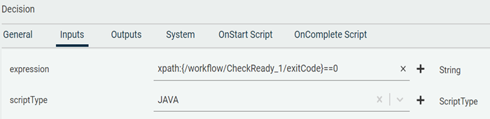

    1. Beside Expression, click +.
    2. The Insert variable dialog box appears.
    3. Go to Client Readiness Report, and then select exitCode.
    4. Click OK.
      Decision Activity_exitCode
    5. Add ==0 to the expression value.
      The value should look as: xpath:{/worfkflow/CheckReady_1/exitCode} ==0. This expression verifies that the exit code of Client Readiness Report is 0.
      Decision Activity Expression Value

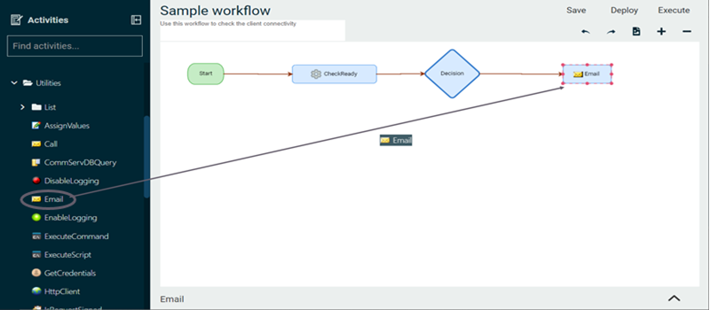

Set Up an Email Activity to Send a Notification When the CheckReady Command Succeeds
  1. Go to Activities > Utilities.
  2. Select the Email activity, and then drag it into the design area.
    Success Email
  3. In the design area, select the Email activity.
    The properties for the Email activity appears at the bottom of the design area.
  4. On the General tab, in the Display Name, rename the activity to Success Email.
    If the qoperation CheckReady command succeeds, the Success Email activity sends an email notification to the specified email address.

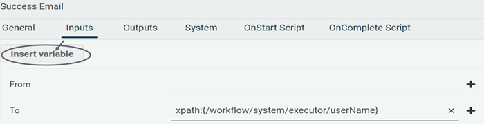

  5. On the Inputs tab, do the following:
Step
Specify the email recipient
  1. Beside the To box, click the Insert variable + button.
  2. Go to system > executor, and then select userName.
  3. Click OK.

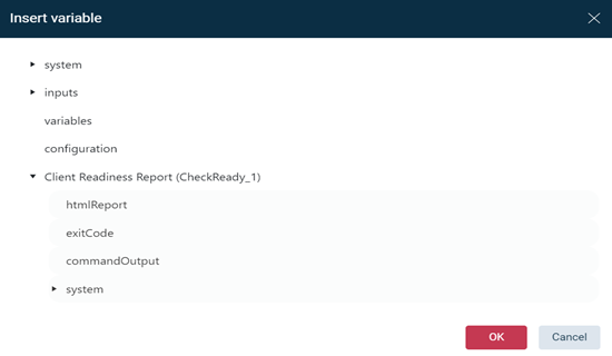

Configure the email body
  1. Place the cursor in the body.
  2. Click Insert variable.
    Success Email Inputs
  3. Go to Client Readiness Report, and then htmlReport.
  4. Click OK.

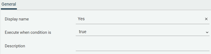

    1. Specify the true conditional transition:
      1. Select the connector (arrow) between Is Report Ready activity and Success Mail activity.
      Success Email Connector
      2. In the Display Name box, enter Yes.
      3. From the Execute when condition is list, select true.
        True Transition

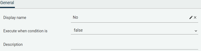

    2. Specify the false condition:
      1. Select the connector (arrow) between Is Report Ready activity and Failure Mail activity.
      2. On the General tab, complete the following:
      3. In the Display Name, enter No.
      4. From the Execute when condition is list, select false.
        False Transition
