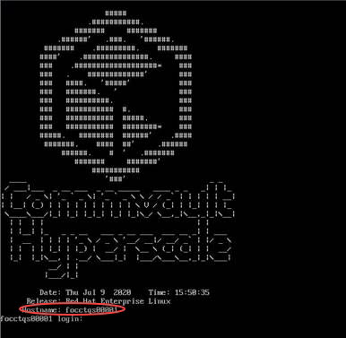

When you power on the nodes, the serial number is displayed as the Hostname as shown in the following sample image:
Configuring the Block (1)
