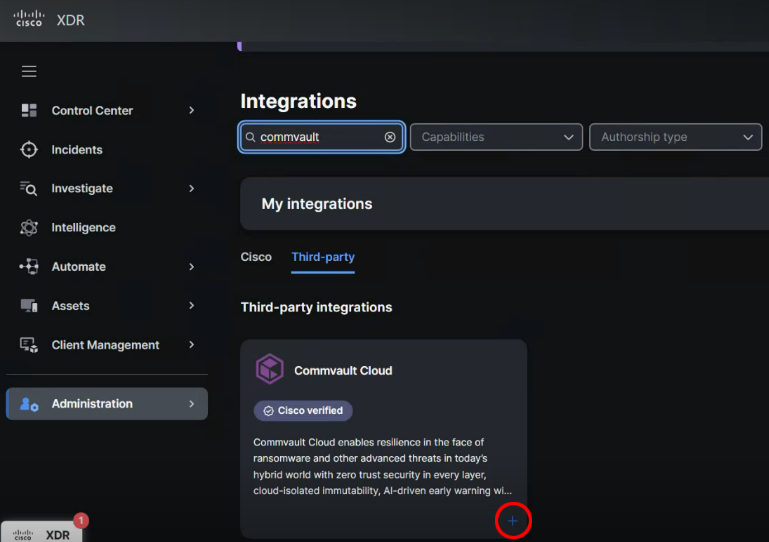

  6. In Cisco XDR, locate the Commvault Cloud third-party integration tile and then click the + button:
    cisco_integration

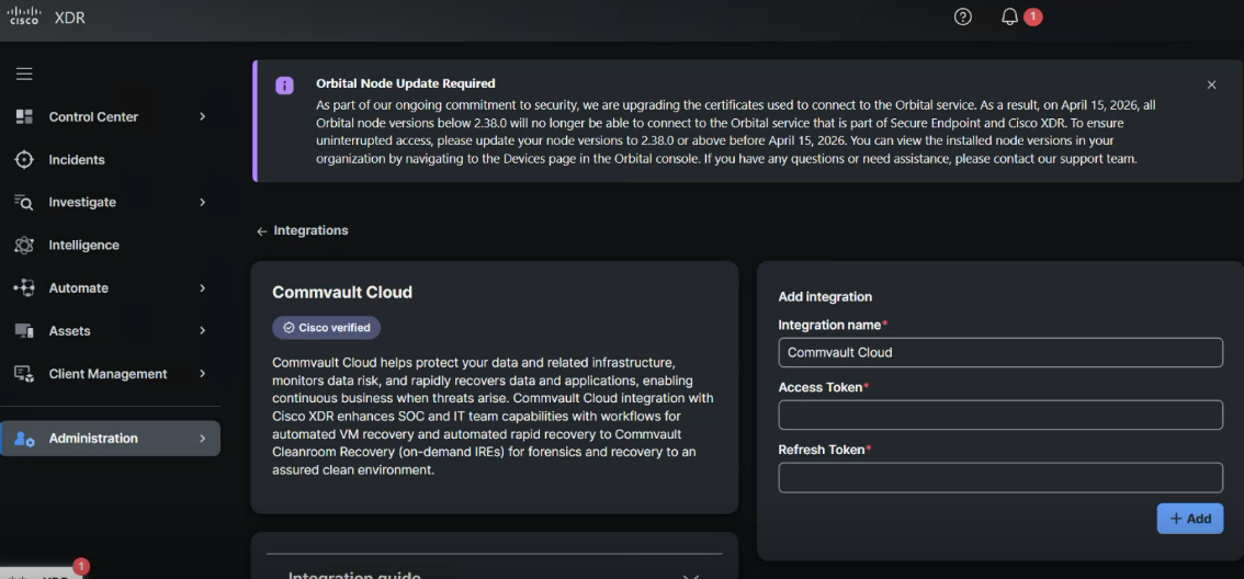

    The Commvault Cloud integration screen appears:
    cisco_integration
  7. In the Add integration section, enter the following:
    • Integration name: Enter "Commvault Cloud".
    • Access Token: Enter the access token that you created in Step 5, above.
    • Refresh Token: Enter the refresh token that you created in Step 5, above.

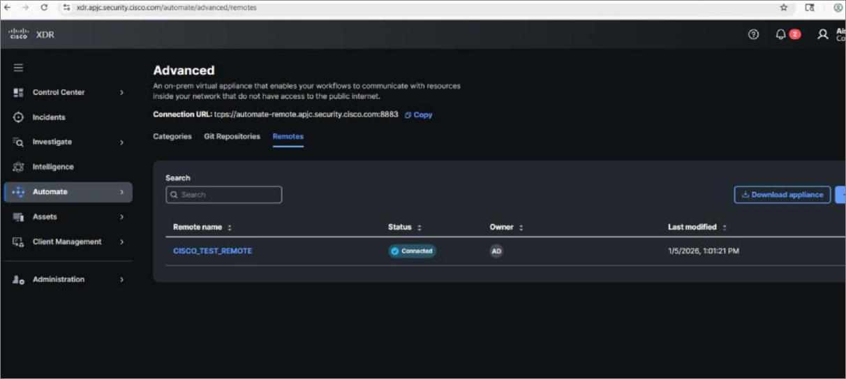

  8. From Automate > Advanced > Remotes, add a remote virtual appliance. For more information, see Cisco XDR - Remote Setup and Deployment.
    cisco_integration
