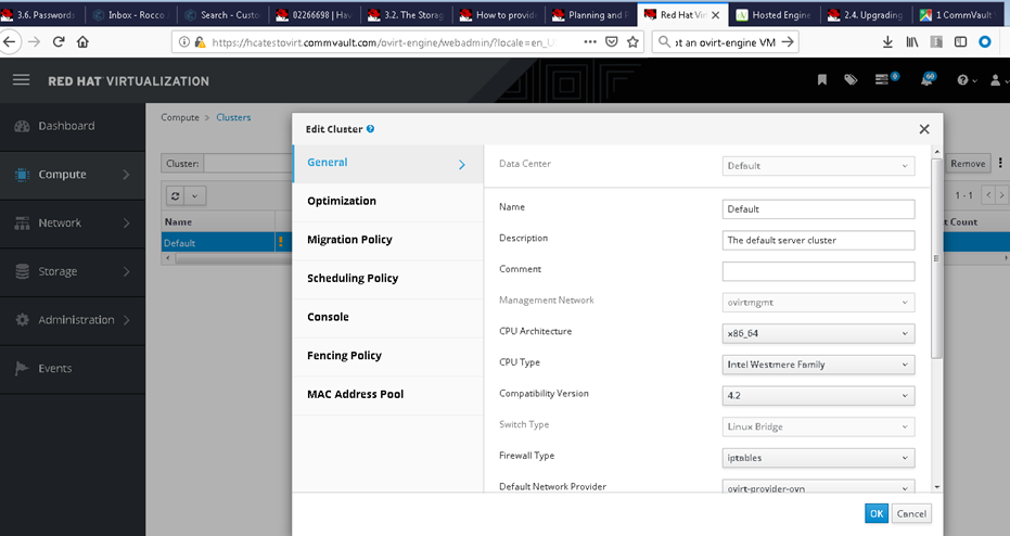

  1. Change the compatibility version from 4.1 to 4.2 in the Administration Portal.
    A power cycle of the VM’s is needed for this to take effect. Hence this may require a scheduled down time for the VM hosting the CommServe.
    1. From the Administration Portal, click Compute > Clusters.
    2. Select the cluster to change and then click Edit.
    3. Change the Compatibility Version to the 4.2.
    4. Click OK twice to confirm the change.

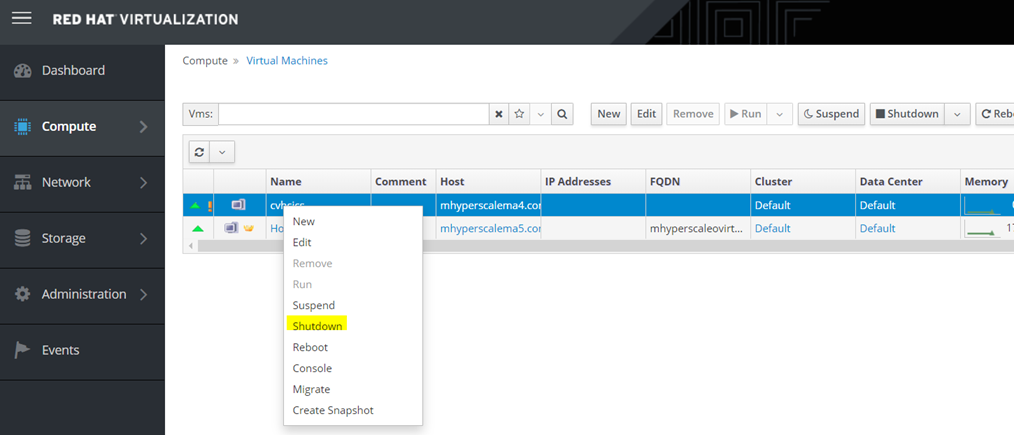

  2. Stop the VM hosting the CommServe.
    1. From the Administration Portal, click Compute > Virtual Machine.
    2. Right click the CommServe VM then click Shutdown.

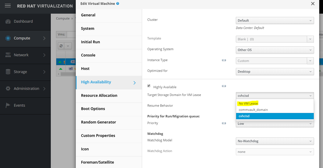

  4. Remove the VM Lease.
    2. Right click the CommServe VM then click Edit.
    3. Change the Target Storage Domain for VM Lease to No VM Lease.
    4. Wait for completion pop-up on upper right corner.
      Upgrading the Hosted Engine (5)
  5. Re-add the VM Lease.
    3. Change the Target Storage Domain for VM Lease to <VM_Name>. (For example, cvhcisd in the above image.)
  6. Stop the VM hosting the CommServe.
  7. Restart the VM hosting the CommServe.
    2. Right click the CommServe VM then click Run.
