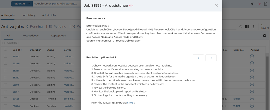

  1. From the Command Center navigation pane, go to Monitor > Jobs.
    The Active jobs page appears.
  2. In the row for the job that is in the pending or failed state, in the Error code column, click the error code.
Results
  • The Job <Job Number> AI Assistance dialog box appears with an error summary and resolution options.
  • To access other resolution options when multiple sets exist, next to Resolution options: set <number>, click the arrows.
