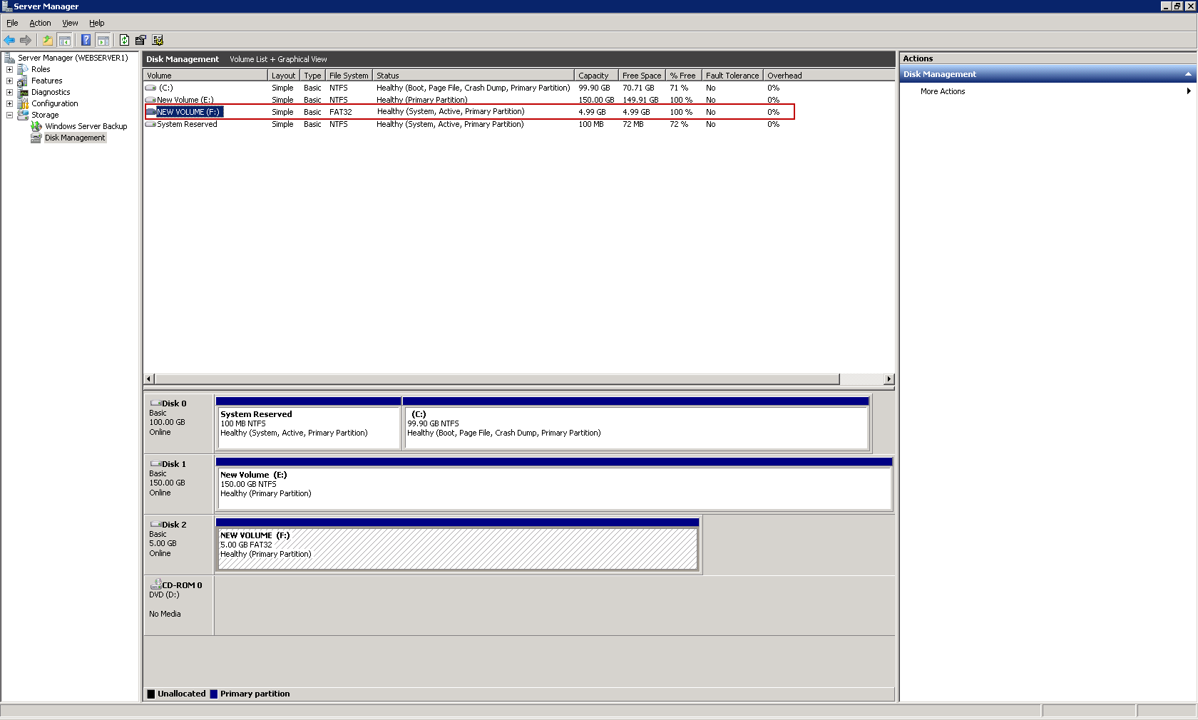

WINFS0015: Backup failures on Windows 2008, Windows 2008 R2 or Windows 7
Symptom
The following errors may be generated during the backup operation:
  • From CommCell Console Event Viewer or Job Details dialog box:
    Error Code 17:55:
     Failed to create a VSS snapshot and it is required in order to run a system state backup. Failing the scan.
     FileScan Error:Cannot scan [\]
  • From the FileScan.log file on the Client server:
    CsVolumeList::Add() - VolGUID path (\\?\Volume{0c022041-ff03-11de-8b2f-806e6f6e6963}\Boot) too long. Truncating.
     GetVolumeMountPointsForVolumeGUID() - Found no path matching vol name [\\?\Volume{0c022041-ff03-11de-8b2f-806e6f6e6963}\].
     CsVolumeList::Add() - Not able to get volume mount points for vol [\\?\Volume{0c022041-ff03-11de-8b2f-806e6f6e6963}].
     CsVolumeList::Add() - Added [\\?\VOLUME{0C022041-FF03-11DE-8B2F-806E6F6E6963}\] to volume list
Once the FileScan.log shows the above error, then system state VSS snap is started for the file scan and the following error message is seen when the files scan or backup fails.
The cause for the failure is that VSS is unable to create a SNAPSHOT of the volume identified.
You may observe the following in the logs:
CsSnapRequestor::StartSnapshotSet() - Starting a new Snapshot Set
 Entering [CsVssBackupComponents::StartShadowSet]
 CsSnapRequestor::StartSnapshotSet() - Created shadow set e4875fdb-5caa-48ed-abfc-da5a3cb34950
 Entering [CsSnapRequestor::AddVolumesToSnapshotSet]
 CsSnapRequestor::AddVolumesToSnapshotSet() - Volume [\\?\VOLUME{0C022041-FF03-11DE-8B2F-806E6F6E6963}\] not supported by provider
 Call AddVolumesToSnapshotSet(ids) [FAILED, throwing CV exception] - Code = 0x80320305, Description = Unknown error
 Call CreateSnapshotSet() [FAILED, throwing CV exception] - Code = 0x80320305, Description = Unknown error
 Entering [CsSnapRequestor::BackupComplete]
 Entering [CsSnapRequestor::DeleteFolderMetadata]
 CsSnapRequestor::DeleteFolderMetadata() - Not attempting to delete folder metadata
 Entering [CsSnapRequestor::DeleteSnapshot]
 CsSnapRequestor::DeleteSnapshot() - Shadow not created!
 CsSnapRequestor::BackupComplete() - Deleted snapshot set
 CsSnapRequestor::BackupComplete() - Aborting backup!
 Entering [CsVssBackupComponents::Delete]
 Entering [CsVssBackupComponents::FreeWriterMetadata]
 CsVssBackupComponents::FreeWriterMetadata() - Free'd all writer metadata
 FindWorkThreadWrapper::createVssSnap() - Not using writers for backup
 FindWorkThreadWrapper::ProcessSysStateComp() - Failed to create a VSS snapshot and it is required to run a system state backup. Failing the scan
Microsoft Application or System Event Logs may display the following Event IDs:
Event IDs 12290 and 16387 are logged when system state backup fails on a Windows Server 2008-based computer.
 Log Name: Application
 Source: VSS
Event ID: 12290
 Level: Warning
 Description: Volume Shadow Copy Service warning: ASR writer Error 0x80070001. hr = 0x00000000.
 Source: SPP
Event ID: 16387
 Level: Error
 Description: Shadow copy creation failed because of error reported by ASR Writer. More info: Incorrect function. (0x80070001).
Solution

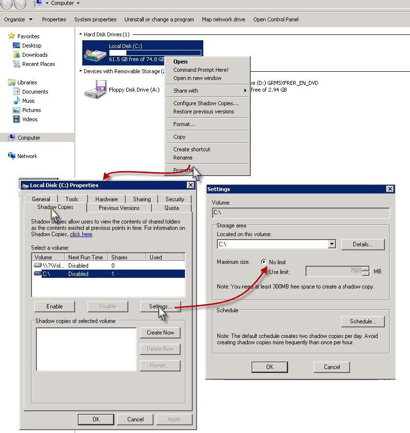

Make sure that the drive that hosts the snapshots has sufficient space to post the new snapshot.
To resolve this issue,

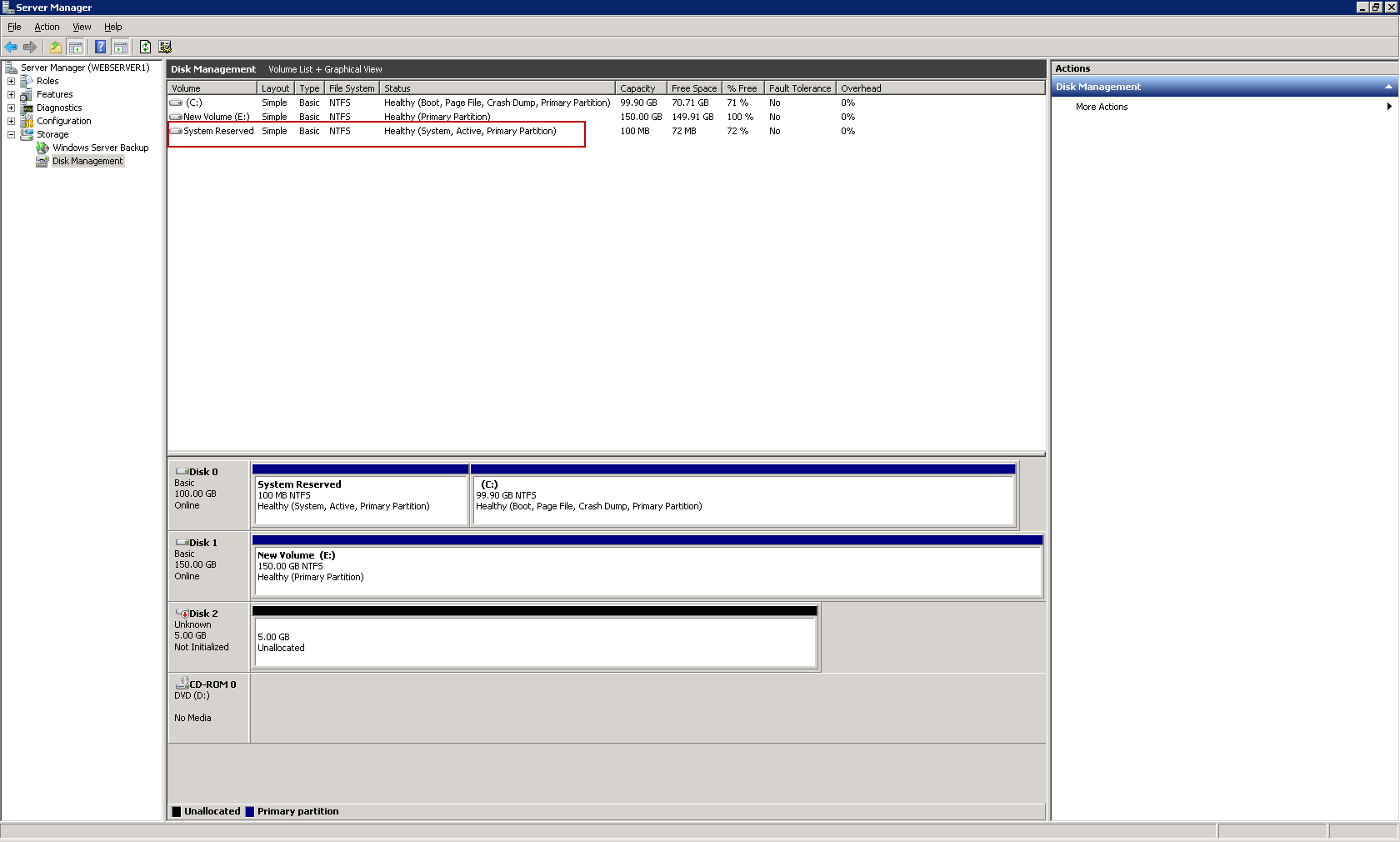

  1. Verify if there is an Active, Primary Partition that is not an NTFS file system and does not have a Volume drive letter assigned.
    unallocated_ntfs1
    The following image is an example of an Active, Primary Partition that is not NTFS (New Technology File System).
    unallocated_ntfs2
    Run mountvol command from the Command Prompt at the administrator level. This will list the volumes available and their names.
    You can also view this list under the registry key located at HKLM\System\MountedDevices.
    Look for a data set without a matching\DosDevice\Volume drive letter. The following is an example of a data set without a matching DosDevice\Volume drive letter:
    Review this with your Server Vendor or Server Image Provider to determine what volume is this for.
    If this does not resolve the issue, refer to Microsoft KB 968128 for more information.

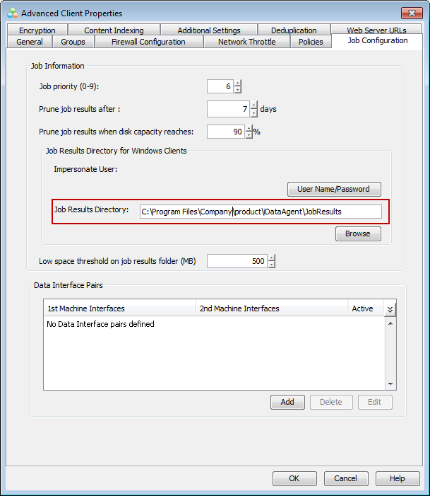

WFS0017: Backup job pending with error: "File Scan failed to write to dirchange file"
Symptom
Backup job goes to a pending state with the following error:
Error Code 17:40
 File Scan failed to write to dirchange file [...] . Possible reasons nonexistent path/file, hardware problems or full disk.
Solution

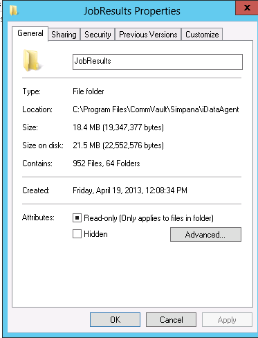

This issue is caused by a problem writing to the Job Results directory on the client computer.
  1. From the CommCell Console, navigate to Client Computers | <Client>.
  2. Click Advanced.
  3. Click Job Configuration tab. The Job Results Directory box contains the path where the job results files are listed.
    Make sure that the given path exists.
    job_results_directory

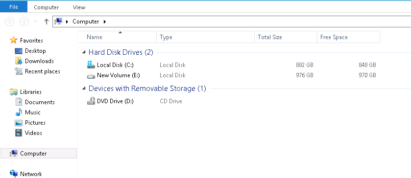

  4. Login to the Client Computer and verify if the current free space available is sufficient for hosting the Job Results Directory.
    For more information on how to determine the free space for Windows 2008 and Windows 2008 R2, see Microsoft KB article 2021748.
    job_results_directory1
  5. Navigate to the path provided in the Job Results Directory box and check the size of the JobResults folder.
    job_results_directory2
  6. Explore the options required to reduce the space or move JobResults folder to another location.

Resolution 4
Follow the steps given below to resolve this issue.
  1. Open My Computer on the client computer.
  2. Right-click on the <volume> and point to Properties.
  3. Click on Shadow Copies tab.
  4. Click Settings.
  5. In the Storage area, select Maximum Size as No Limit or the set the space limit required for the VSS copies. You can also move the holding section to another volume.
    vss_space_issues
For Command Line, see Microsoft article Vssadmin add shadowstorage.

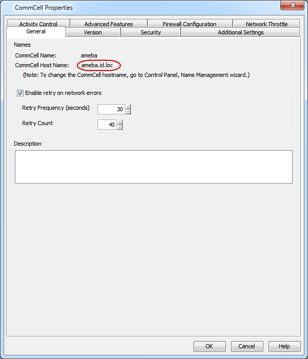

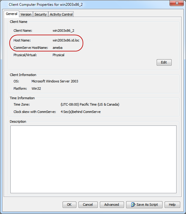

  1. From the CommCell Browser, right click the CommServe and click Properties. Check the CommCell Host Name.
    kb1
  2. From the CommCell Browser, right click the Client computer and click Properties. Check the Host Name and CommServe Host Name.
    kb2

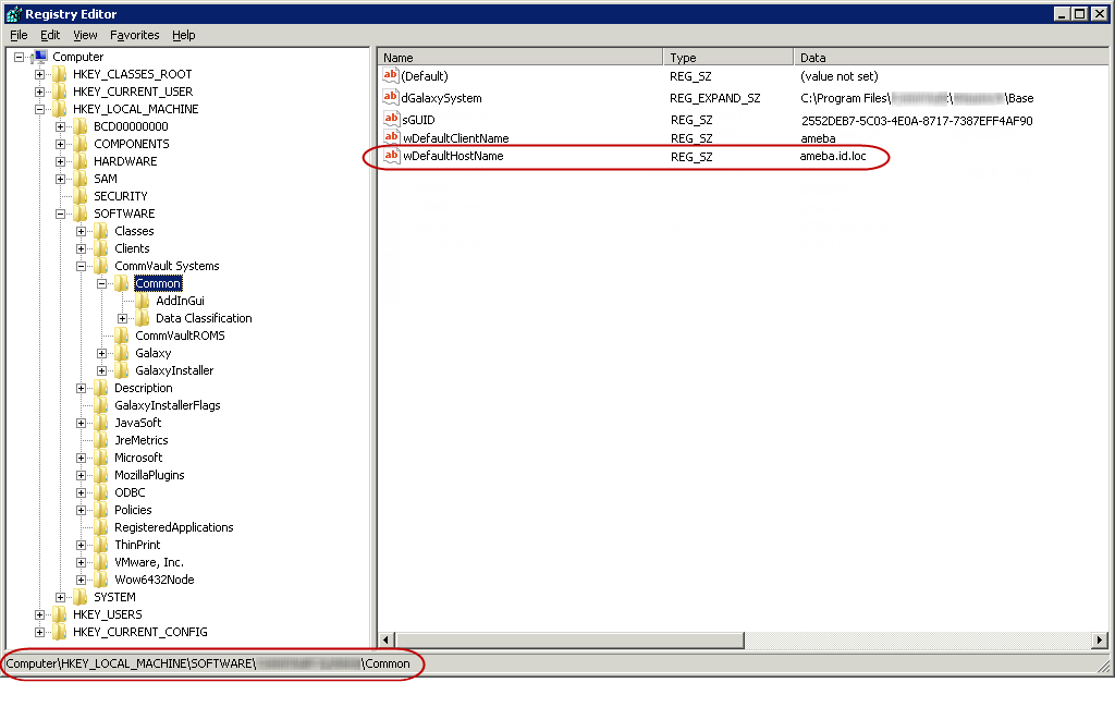

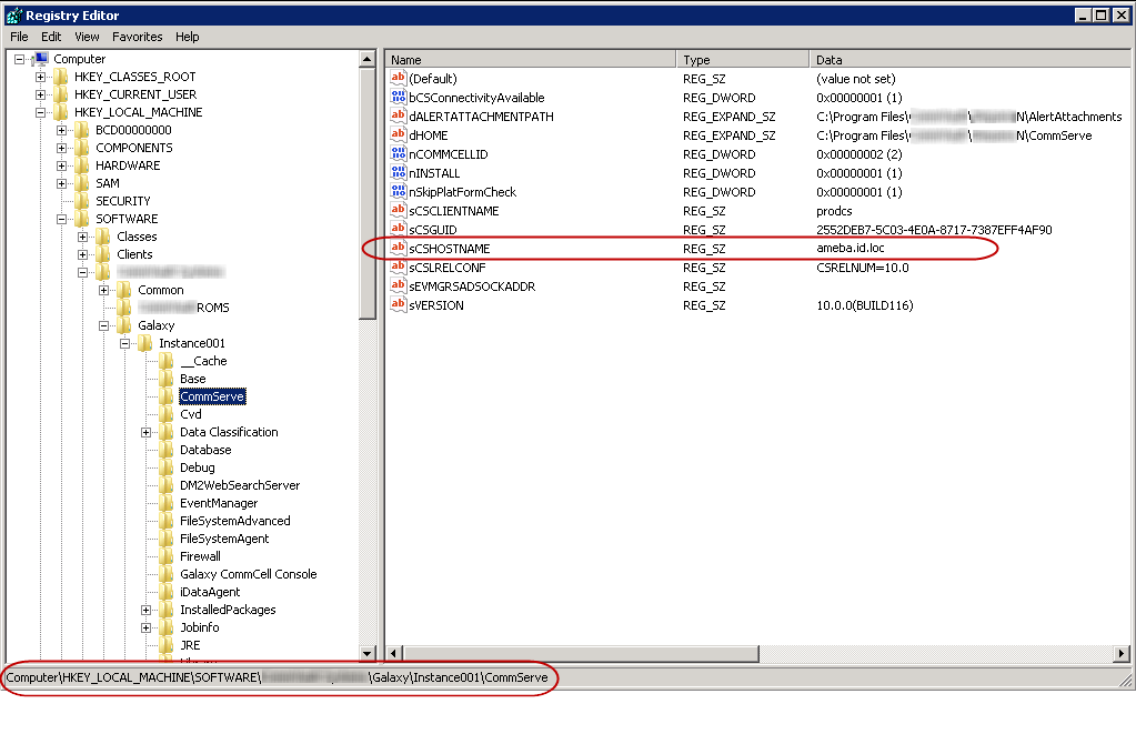

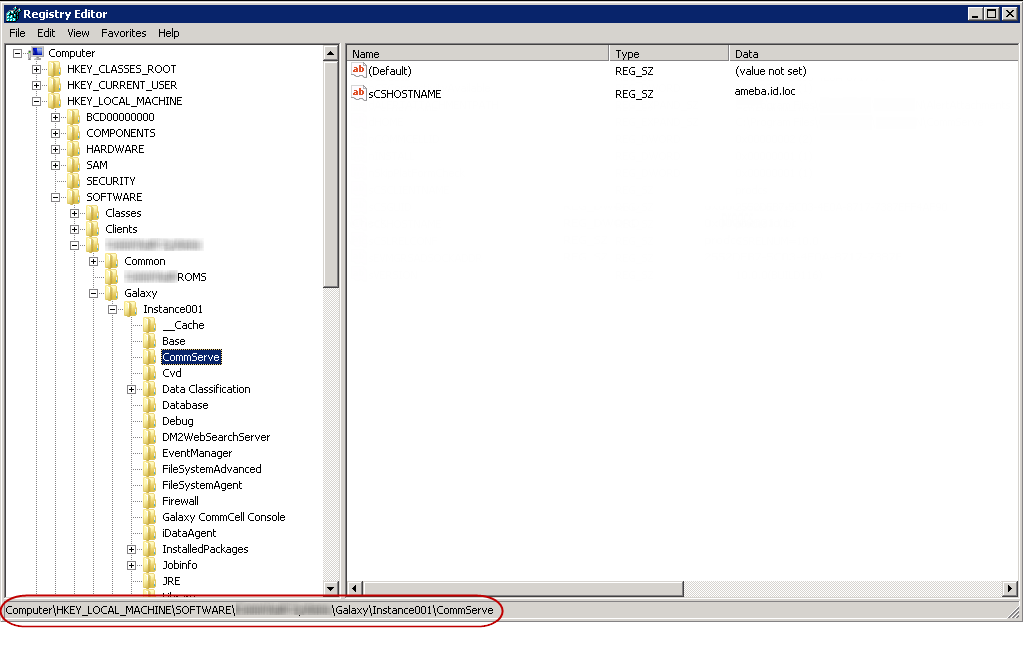

  3. The registry on the CommServe (CS) will have two locations that show the CS Host Name when it also has a Client (CL) installed.
    For the CommServe Name used by the Clients other then the CommServe Client the registry entry for sCSHOSTNAME is located under \HKLM\Software\Commvault Systems\Galaxy\Instance001\CommServe
    kb3
    For the CommServe with a Client (CL) File System Agent installed, the name is hosted at this registry location.
    Registry entry for wDefaultHostName is located under \HKLM\Software\Commvault Systems\Common
    kb4
  4. Now to get the information for the MediaAgent (MA) or the Client (CL), locate the MA or CL in the CommCell Browser window, right click, and then click Properties. On the General tab, the following will be displayed.
    Client used as example here:
    kb2
  5. Now once the MediaAgent (MA) and/ or Client (CL) CommCell information is confirmed, go to the MA and/or CL and review the registry entries for the Name.
    Client computer is used for example here.
    • To confirm the CL Host Name, check the registry on the CL for the entry wDefaultHostName located under \HKLM\Software\Commvault Systems\Common.
      kb5
    • Now confirm the CommServe Hostname on the CL in the registry for the entry sCSHOSTNAME located under \HKLM\Software\Commvault Systems\Galaxy\Instance001\CommServe
      kb6

  2. Check the sCSHOSTNAME additional setting.
    • From the CommCell Browser, navigate to Client Computers.
    • Right-click the <Client> or <MediaAgent>, and then click Properties.
    • Click Advanced and then click AdditionalSettings tab.
    • Click Add.
    • In the Name box, type sCSHOSTNAME.
    • The Category and Type fields are populated automatically.
    • In the Value box, if the current string value has _Disabled_ appended at the front of the string value, remove it to allow communication to the CommServe.
    • Click OK.
    • Click Add.
    • Click OK.
