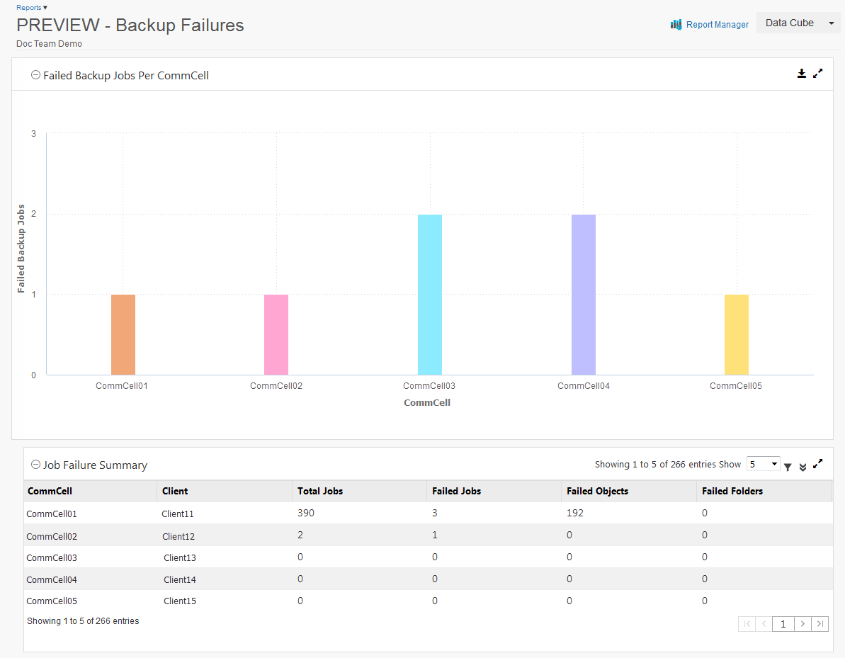

  6. From the Visualization tab, drag Data Table to the Drop components to build the report box.
    1. From the Data Set list, drag field names to the Data Table:
      1. Data Source
      2. ClientName
      3. TotalJobs
      4. Failed
      5. FailedObjects
      6. FailedFolders
    2. Select the table, and on the Properties tab, click General properties_general.
    3. In the Title box, type Job Failure Summary.
  7. On the Properties tab, click Fields fields_tab, and then configure sorting and column names:
    1. Next to Sorting, click Add Sorting add_data_source, select Failed Jobs from the list, and then select Desc.
      The data in the table is sorted by the number of Failed Jobs in descending order.

  8. From the Visualization tab, drag Vertical Bar Chart to the Drop components to build the report box.
    1. From the Data Set list, drag Failed to the Drop Y-Axis box.
    2. From the list under Drop Y-Axis, select Distinct.
    3. From the Data Sets list, drag Data Source to the Drop X-Axis box.
      The chart you created appears in the report builder.
    4. On the Properties tab, click General properties_general, and configure the chart titles:
      1. In the Chart Title box, type Failed Backup Jobs Per CommCell.
      2. In the Y-Axis Title box, type Failed Backup Jobs.
      3. In the X-Axis Title box, type CommCell.
  9. On the Properties tab, click click Fields fields_tab and configure custom colors for the bars:
    1. Next to Custom Colors, click Customize Series Colors sorting_add.
    2. Select each X-Axis from the list, and then click the box next to it.
      custom_colors
    3. Click the Default Color box, select a color from the Color dialog box, and then click OK.
      Any bar that is not configured with a custom color displays the color configured in the Default Color box.
  10. Click Preview to see what the report will look like.
    custom_report_example
  11. At the top of the page, click Save, and then click Deploy.
    The report appears on the Worldwide Reports page under Untagged.
