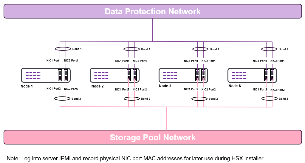

Bonded topology is the most common option for HyperScale as this provides network level redundancy for each node.
In this topology, each node requires connections to 2 separate network as follows:
  • 2 - 10 GbE port for data protection network, which transfers data to and from the clients being protected and connect to the CommServe server.
  • 2 - 10 GbE port for storage pool network, which is a dedicated private network, used for communication and replication between the HyperScale nodes.
Bonded topology is the most used configuration and is recommended for most deployments. The bonding can be configured to provide redundancy using either the Active-Backup bonding or the Link Aggregation Control Protocol (LACP). This can also be used with a multi-switch link aggregation protocol such as Virtual Port Channel (VPC), MLAG, or MC-LAG to provide switch level redundancy.
embd_bonded_topology_desc (1)
  • Each pair will be bonded on the node, so it is treated as one logical connection. If a node encounters a cable, SFP, or network card failures, the node remains operational without any user intervention. This can optionally be setup to connect to 2 switches to provide switch level redundancy.
  • Active-Backup and Link Aggregation Control Protocol (LACP) are the supported bonding modes.
    LACP requires the switch(s) to support it as well. When using LACP, each pair of ports should be configured as an active port-channel, and not configured to negotiate the aggregation protocol.
Network Requirements
  • 2 - 10 GbE bonded ports for the data protection network, which transfers data to and from the clients. This requires a corresponding IP address for the data protection network.
  • 2 - 10 GbE bonded ports for the storage pool which is a dedicated private network, used for communication and replication between the HyperScale nodes. This requires a corresponding IP address for the storage pool network.
Data Protection and storage pool networks MUST be on two separate subnets.

Cabling and Cable Connections
  1. Connect 2 - 10 GbE data protection ports from each node to the data protection network.
    All data management tasks including backups and restores, are established through these 2 - 10 GbE data protection ports.
  2. Connect 2- 10 GbE storage pool port from each node to the private storage pool network.
    All storage related tasks, including all cluster connectivity for the storage pool network, will be through these 2- 10 GbE storage pool ports.
  3. Connect the 1 GbE IPMI port (BMC Controller) from each node to the IPMI or management or utility network for lights out access.
