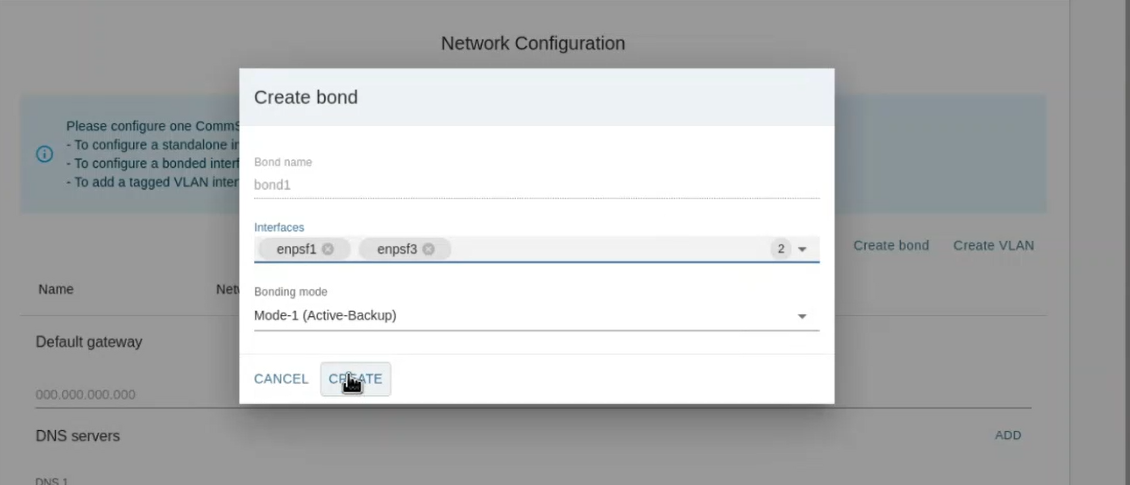

  4. Create a data protection interface bond as follows:
    1. Click Create bond.
    2. From the Interfaces list, select the data protection interfaces. (enpsf3 or enpsf5)
    3. From Bonding mode list, select either active-backup (Mode 1) or LACP (Mode 4).
    4. Click CREATE. robo_linux_bond_install_bond2

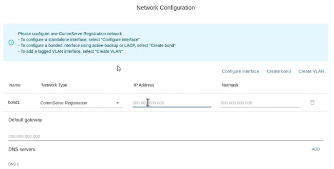

    5. From the Network Type list, select CommServe Registration
    6. Add the IP Address and Netmask in the respective boxes.
      robo_linux_bond_install_bond3

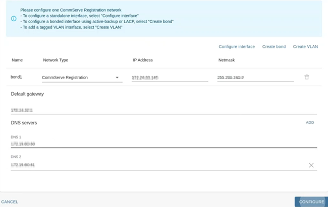

  5. Configure the DNS server(s) as follows:
      robo_linux_bond_install_bond4
    3. Click CONFIGURE.
      robo_linux_bond_install_bond5
  6. Verify the network configuration and then click CONTINUE.
